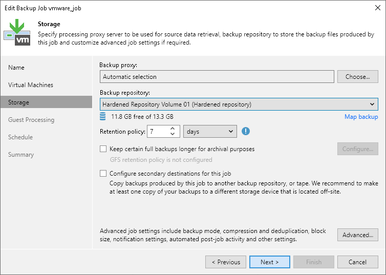

  1. Go to the Jobs node and edit the job associated with the Linux repository. At the Storage step of the wizard, select the hardened repository from the Backup repository list.
Switching from a Linux Repository to a Hardened Repository
Click Map backup and specify imported backups from the previous step.
Finish the wizard to apply changes.

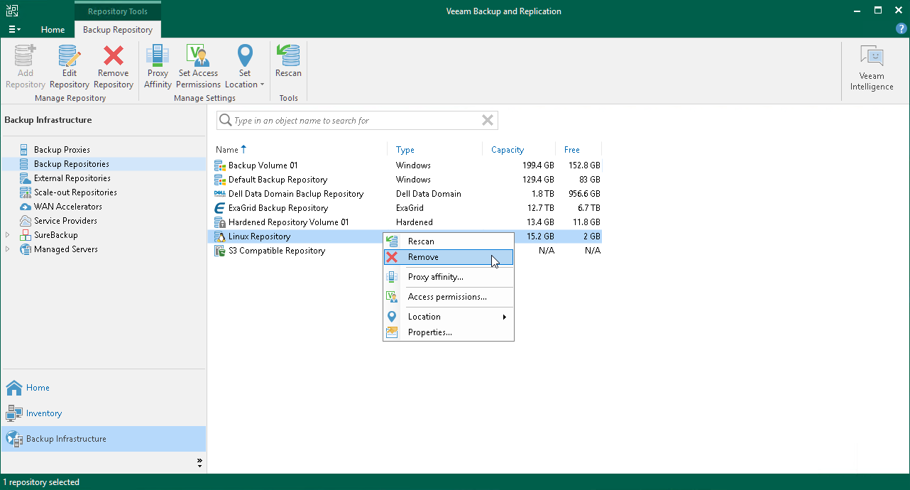

  1. Open the Backup Infrastructure view and remove the Linux backup repository from the backup infrastructure.
