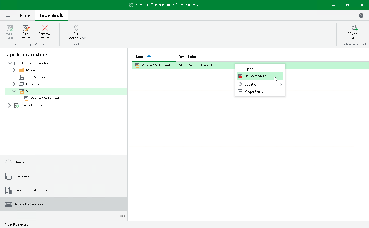

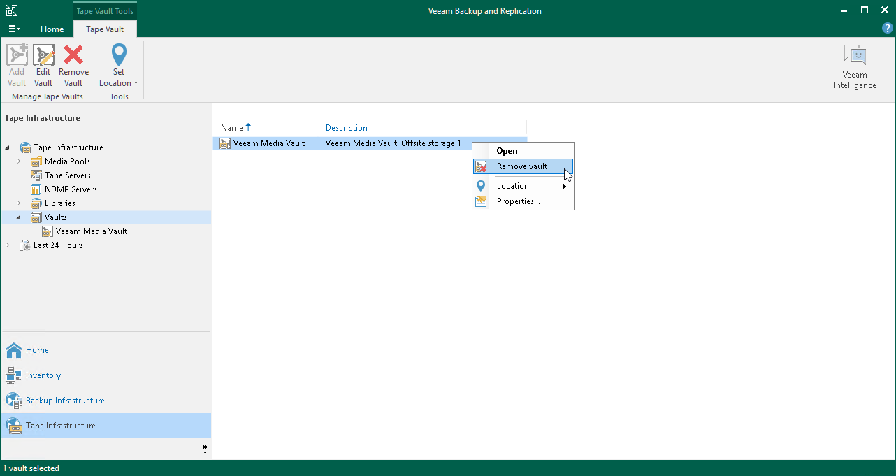

To remove a vault:
  1. Open the Tape Infrastructure view.
  2. Navigate to the Vaults node.
  3. Select a vault and click Remove Vault on the ribbon. Alternatively, you can right-click the necessary vault in the working area and choose Remove Vault.
  4. In the displayed dialog box, click OK to confirm deletion.
