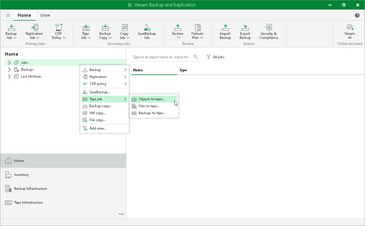

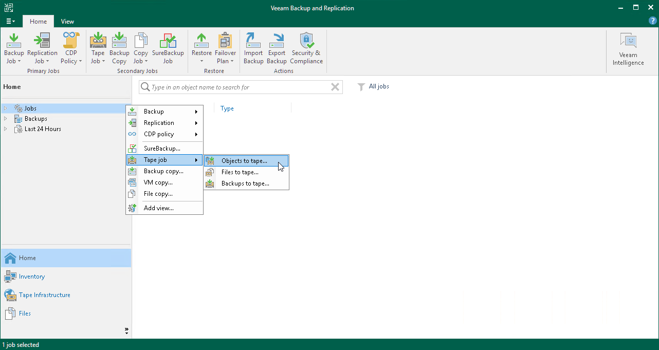

Step 1. Launch New Object to Tape Job Wizard
To run the New Object to Tape Job wizard, do either of the following:
  • On the Home tab, click Tape Job and select Objects.
  • Open the Home view, right-click the Jobs node and select Tape Job > Objects to Tape.
