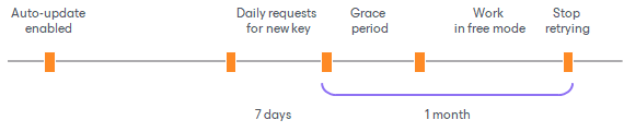

  1. After you enable automatic license update, Veeam Backup & Replication starts sending requests to the Veeam License Update Server on the web (autolk.veeam.com) and checks if a new license key is available. Veeam Backup & Replication sends requests once a week. Communication with the Veeam License Update Server is performed over the HTTPS protocol.
  2. Seven days before the expiration date of the current license, Veeam Backup & Replication starts sending requests once a day.
  3. When a new license key becomes available, Veeam Backup & Replication automatically downloads it and installs on the backup server or Veeam Backup Enterprise Manager server.

  • If Veeam Backup & Replication fails to establish a connection to the Veeam License Update Server, retry takes place every 60 min.
  • If Veeam Backup & Replication establishes a connection but you are receiving the “General license key generation error has occurred” message, the retry takes place every 24 hours.
The retry period ends one month after the license expiration date or the support expiration date (whichever is earlier). The retry period is equal to the number of days in the month of license expiration. For example, if the license expires in January, the retry period will be 31 day; if the license expires in April, the retry period will be 30 days.
If the retry period is over but the new license has not been installed, the automatic update feature is automatically disabled.

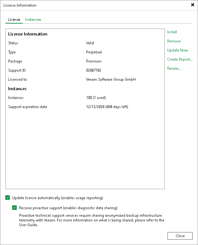

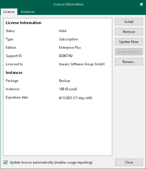

By default, automatic license update is disabled. To enable automatic license update:
  1. From the main menu, select License.
  2. In the License Information window, select the Update license automatically (enabled usage reporting) check box.
Updating License Automatically
During the installation of a Subscription or Rental license, you will see a dialog box with a suggestion to enable automatic license update.
Statistics on the automatic license update process is available under the System node in the History view. You can double-click the License key auto-update job to examine session details for the scheduled or ad-hoc automatic license update.
[For Rental, Subscription, Perpetual licenses] Enabling license auto update activates Automatic License Usage Reporting.
