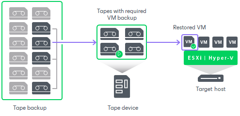

How Restoring VM from Tape to Infrastructure Works
Restore Directly to Infrastructure
For each VM, Veeam starts a separate restore job. However, you can select multiple VMs to restore: in this case, Veeam will queue the restore jobs and run them one after the other.
For restoring a VM directly to the infrastructure, Veeam Backup & Replication performs the following steps:
  1. The VM from tape restore job checks the Backup Catalog in the Veeam Backup & Replication database to discover the tapes containing the needed backup files. If the tapes are offline, Veeam Backup & Replication prompts the user to insert the required tapes.
Veeam needs to load and read the selected tapes 3 times.
  1. Veeam loads the tapes for the 1st time.
  2. Veeam reads metadata and caches it on the tape server. This requires approximately 100Mb of disk space per 1TB of tape data for the default data block size.
  3. Using the cached data, Veeam builds a map of data blocks. The map contains referenced to the data blocks of the VM you restore: the VM configuration file and the VM disks data.
  4. Veeam loads the tapes for the 2nd time.
  5. Veeam restores the VM configuration:
  • To restore to original location, Veeam synchronizes the VM configuration file up to the backup state.
  • To restore to another location, Veeam copies the VM configuration file and registers the VM on the target host.

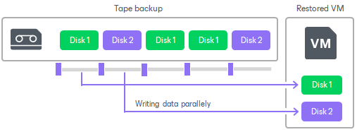

  1. Veeam loads the tapes for the 3rd time.
  2. Veeam restores the VM disks. Multiple disks are restored parallelly. Veeam reads the tape consequently and, using the map of data blocks, copies the VM disks data.
