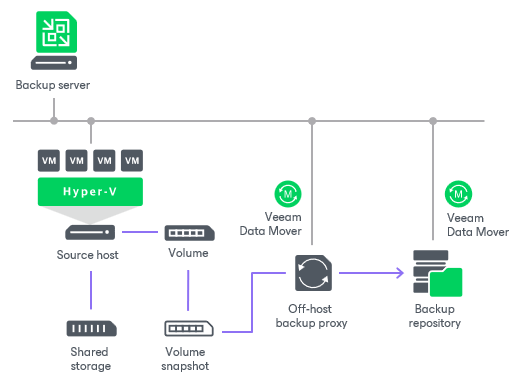

In the off-host backup mode, backup processing is shifted from the source Microsoft Hyper-V host to a dedicated machine — an off-host backup proxy.
The off-host backup proxy acts as a “data mover”. Veeam Data Mover running on the off-host backup proxy retrieves VM data from the source volume, processes it and transfers data to the destination. This type of backup does not impose a load on the source host. As resource-intensive data processing operations are performed on the off-host backup proxy, production hosts remain unaffected.
To perform off-host backup, Veeam Backup & Replication uses transportable shadow copies. The transportable shadow copy technology lets the backup application create a snapshot of a data volume on which VM disks are located, and import, or mount, this snapshot onto another server in the same subsystem (SAN) for backup and other purposes. The transport process is accomplished in a few minutes, regardless of the amount of the data. The process is performed at the SAN storage layer, so it does not impact host CPU usage or network performance. For more information about transportable shadow copies, see Microsoft Docs.

The off-host backup process is performed in the following way:
  1. Veeam Backup & Replication triggers a snapshot of the necessary volume on the Microsoft Hyper-V host.
  2. The created snapshot is detached from the host and mounted to the off-host backup proxy.
  3. Veeam Data Mover, running on the off-host backup proxy, uses the mounted volume snapshot as a data source. It retrieves VM data from the volume snapshot, processes it and transports it to the destination.
  4. After the backup process is complete, the snapshot is dismounted from the off-host backup proxy and deleted on the storage system.
