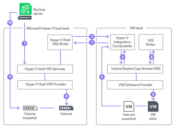

Online backup for VMs on Microsoft Hyper-V Server 2012 is performed in the following way:
  1. Veeam Backup & Replication interacts with the Microsoft Hyper-V host VSS Service and requests a backup of a specific VM.
  2. The Microsoft VSS Writer on the Microsoft Hyper-V host passes the request to the Microsoft Hyper-V Integration Components (HV-IC) installed inside the VM guest OS.
  3. The HV-IC acts as a VSS Requestor for the framework inside the VM. It communicates with this framework and requests a backup of Microsoft VSS-aware applications running on the VM.
  4. VSS Writers for Microsoft VSS-aware applications on the VM are instructed to quiesce application data.
  5. After the applications are quiesced, the framework inside the VM takes an internal snapshot using a Microsoft VSS software provider in the VM guest OS.
  6. The VM returns from the read-only state to the read-write state, and operations inside the VM are resumed. The created snapshot is passed to the HV-IC.
  7. The HV-IC notifies the hypervisor that the VM is ready for backup.
  8. The Microsoft Hyper-V host VSS provider takes a snapshot of a volume on which VM disks are located (external snapshot). After that, Microsoft VSS triggers the auto-recovery process. For more information, see Auto-Recovery.
  9. The volume snapshot is presented to Veeam Backup & Replication. Veeam Backup & Replication reads VM data from the volume snapshot in one of two backup modes — on-host backup or off-host backup.
  10. After the backup is complete, the volume snapshot is deleted.

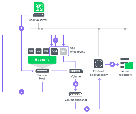

Online backup is performed in the following way:
  1. Veeam Backup & Replication requests a production checkpoint of a specific VM.
  2. Microsoft Hyper-V Virtual Machine Management Service (for Microsoft Windows VMs) or file system freeze (for Linux VMs) brings data on the VM guest OS to a consistent state.
  3. Microsoft Hyper-V Virtual Machine Management Service creates a production checkpoint for the VM. Every virtual disk of a VM receives a temporary AVHDX file. All new writes are redirected to temporary AVHDX files.
  4. Further activities depend on the backup mode:
    • In the on-host backup mode, Veeam Backup & Replication takes a VM checkpoint and reads data from the base disk. After the VM processing is complete, the production checkpoint is merged with the original VM.
    • In the off-host backup mode, the Microsoft Hyper-V host VSS provider takes a snapshot of a volume on which VM disks are located. The volume snapshot is mounted to the off-host backup proxy and presented to Veeam Backup & Replication. Veeam Backup & Replication reads VM data from a base disk on the volume snapshot. After the VM processing is complete, the production checkpoint is merged with the original VM. When all VMs in the group for which the volume snapshot is created are processed, Veeam Backup & Replication triggers volume snapshot deletion.
