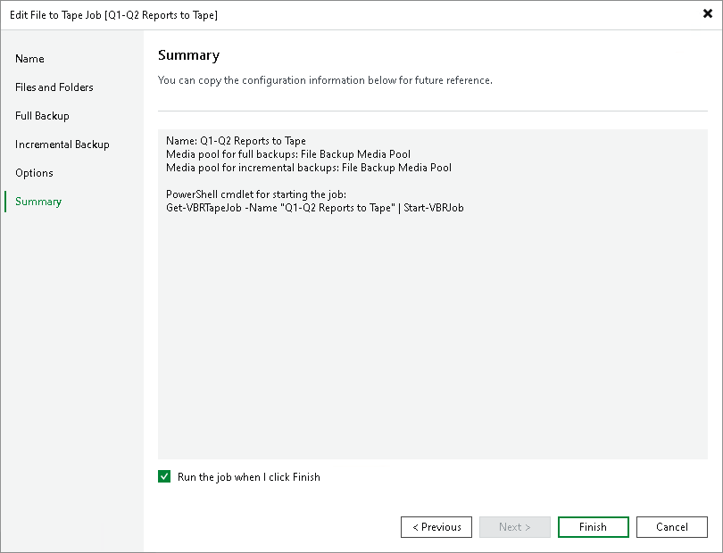

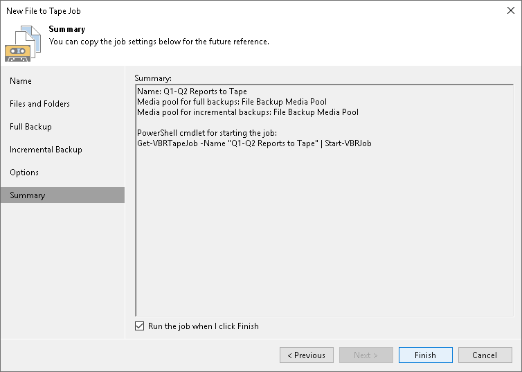

At the Summary step of the wizard, review the settings of the file to tape job. Select the Run the job when I click Finish check box if you want to start archiving file to tape job right after you complete working with the wizard. Click Finish to close the wizard.
