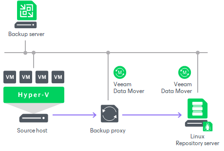

Linux Backup Repository Deployment
To communicate with a Linux-based repository, Veeam Backup & Replication uses two Veeam Data Movers that are responsible for data processing and transfer:
  • Veeam Data Mover on the backup proxy
  • Veeam Data Mover on the Linux backup repository
For more information about Veeam Data Movers communication with a Linux-based server, see Veeam Data Mover Service.
Veeam Data Mover establishes a connection with the source-side Data Mover on the backup proxy, enabling efficient data transfer over LAN or WAN.
