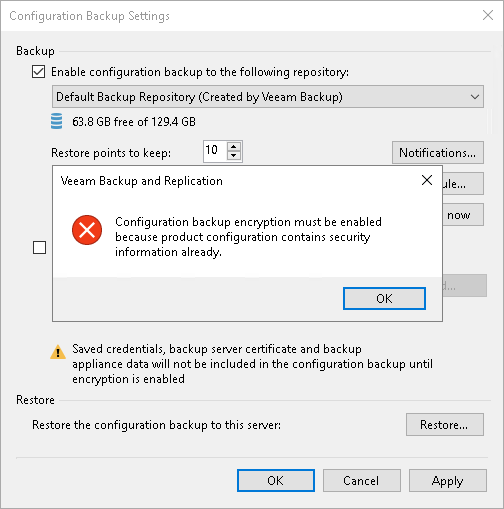

If the configuration backup is unencrypted, data from it can be restored to any backup server. Credentials, encryption keys, and certificates will not be stored in the configuration backup. The content of encrypted files and access to the backup infrastructure will become unavailable after the configuration restore. Additionally, sensitive information such as machine or server IP addresses may be exposed to unintended audiences.
If the Password Manager contains at least one password, and you do not enable encryption for the configuration backup, Veeam Backup & Replication disables configuration backup. To enable the configuration backup, you must enable encryption in the configuration backup job settings.

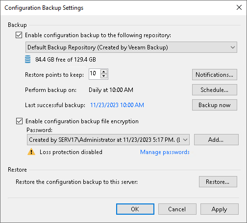

To encrypt the configuration backup:
  1. From the main menu, select Configuration Backup.
  2. Select the Enable backup file encryption check box.
  3. From the Password field, select a password you want to use for encryption. If you have not created the password beforehand, click Add or use the Manage passwords link to specify a new password. For more information, see Password Manager.
For more information about data encryption, see How Data Encryption Works.
If you do not use password loss protection, Veeam Backup & Replication will display a warning about it. For more information, see Password Loss Protection.
