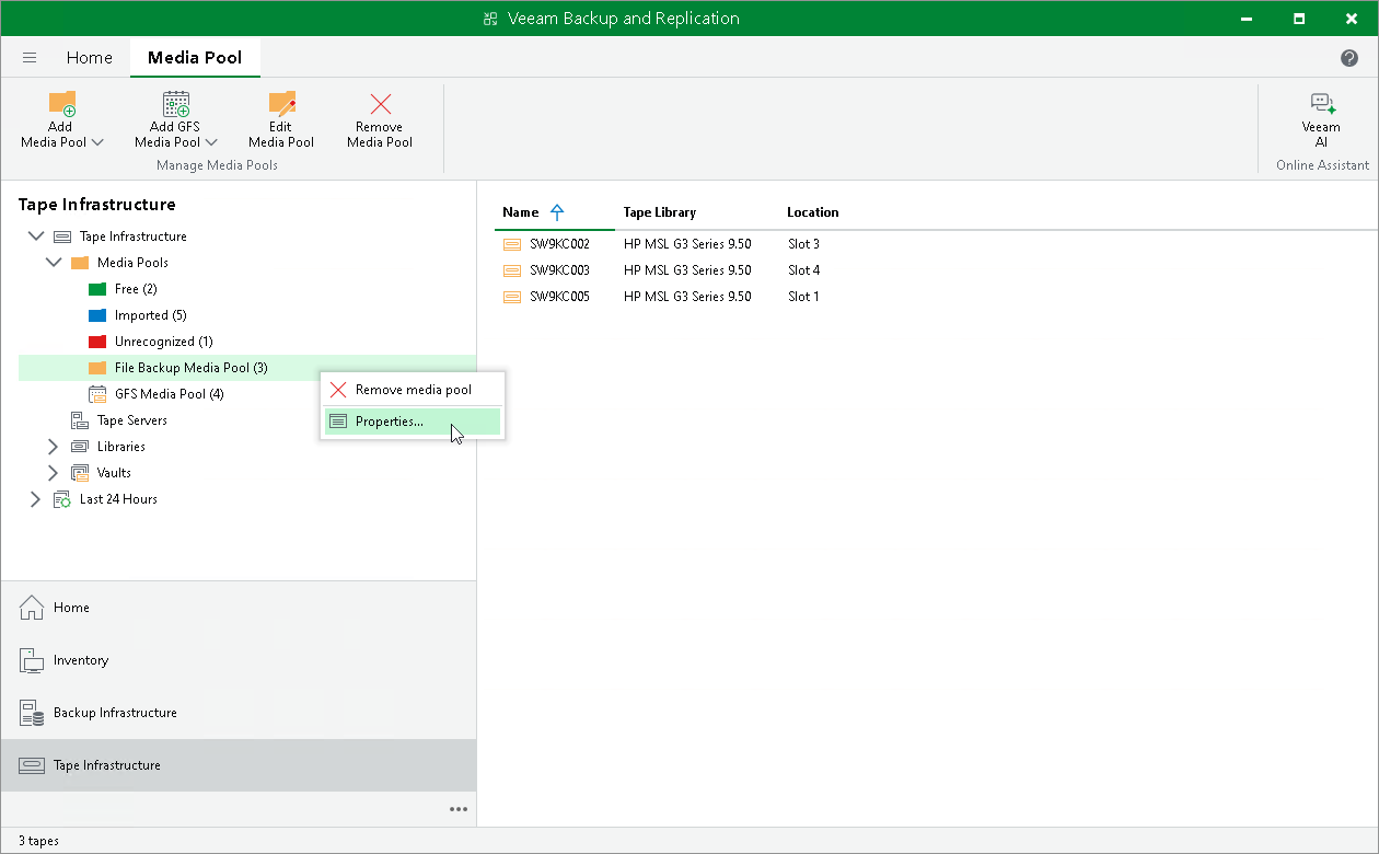

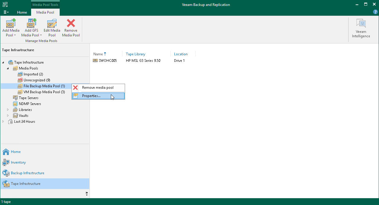

To modify media pool settings:
  1. Open the Tape Infrastructure view.
  2. Navigate to the Media Pool node.
  3. Right-click the necessary media pool and choose Properties. Alternatively, select a media pool and click Edit Media Pool on the ribbon.
  4. Go through the Edit Media Pool wizard to change the necessary settings.
  5. Apply changes.
