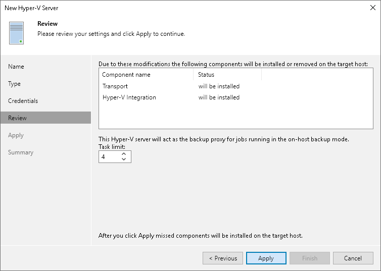

Task Limitation for Backup Proxies
During data protection or disaster recovery jobs, Veeam Backup & Replication creates a separate task per each disk of every VM added to the job.
We recommend that you define the maximum number of concurrent tasks depending on the number of CPU cores available on the off-host proxy/Hyper-V host performing the role of the proxy. To calculate the optimum limit, we recommend that you follow the rule: not more than 2 tasks per 1 CPU core.
To limit the number of concurrent tasks on an off-host backup proxy, you must define the Max concurrent tasks setting for the backup proxy. For onhost backup, you must define the Task limit setting for the source Microsoft Hyper-V host.

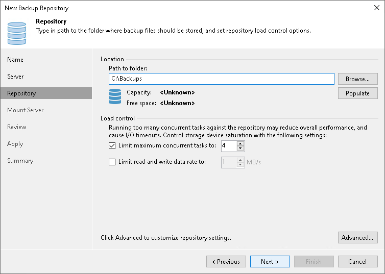

Task Limitation for Backup Repositories
The number of tasks that Veeam Backup & Replication creates during data protection or disaster recovery jobs depends on the type of backup chains stored on the backup repository:
  • For regular backup chains, Veeam Backup & Replication creates 1 task per job.
  • For per-machine backup chains, Veeam Backup & Replication creates 1 task per every VM disk (that is, a disk of a VM added to the job).
Synthetic operations performed in the backup repository (such as synthetic full backup, backup files merge and transformation) are also regarded as tasks. The number of tasks performed during these operations also depends on the type of backup chains stored on the backup repository:
  • For per-machine backup chains, Veeam Backup & Replication creates 1 task per every VM chain (that is, every VM added to the job).
We recommend that you define the maximum number of concurrent tasks based on the number of CPU cores and RAM available on the backup repository. To calculate the optimum limit, follow the rule: not more than 2 tasks per 1 CPU core, not less than 1 GB RAM for each concurrently processed machine disk and not less than 4 GB RAM for each concurrently processed unstructured data source (in case of deduplicating storage appliances, up to 8 GB RAM). In case of shared folder backup repositories, the same amount of resources is required for gateway servers.
To limit the number of concurrent tasks in a backup repository, you must enable the Limit maximum concurrent tasks to <N> option on the backup repository and define the necessary task limit.
If you use backup repositories for backup copy jobs, you must also consider tasks for read operations.
When you limit the number of tasks for the backup repository, consider the storage throughput. If the storage system is not able to keep up with the number of tasks that you have assigned, it will be the limiting factor. It is recommended that you test components and resources of the backup infrastructure to define the workload that they can handle.
