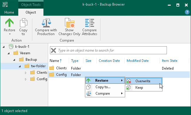

Restoring Objects and Prefixes to Original Location
To restore objects and prefixes to the original location, in the Veeam Backup browser right-click an object or prefix and select one of the following commands:
  • To overwrite the original object in the object storage with the object restored from the backup, select Restore > Overwrite.
  • To save the object restored from the backup next to the original object, select Restore > Keep.
Veeam Backup & Replication will add the _RESTORED_YYYYMMDD_HHMMSS suffix to the original object name and store the restored object in the same prefix where the original object resides.

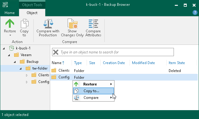

Saving Objects and Prefixes to New Location
To save objects and prefixes to a new location, right-click the necessary object or prefix and select Copy to. Alternatively, you may use the Copy to option in the ribbon.
If you restore objects and prefixes to a new location, you will be prompted to the Specify Destination for Object Restore step to specify a new destination.

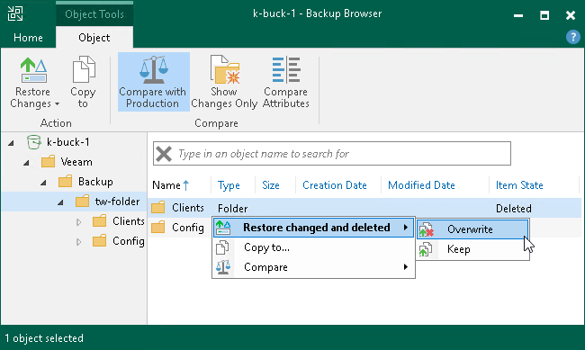

Restoring Changed Objects and Prefixes
After you filter the changed objects and prefixes, you can restore them.
To restore changed and deleted objects and prefixes to the original location, do the following:
  1. In the Veeam Backup browser right-click an object or prefix with Changed or Deleted item state.
  2. Select one of the following commands:
  • To overwrite the original object or prefix on the object storage with the object restored from the backup, select Restore changed and deleted > Overwrite.
  • To save the object or prefix restored from the backup next to the original object, select Restore changed and deleted > Keep.
Veeam Backup & Replication will add the _RESTORED_YYYYMMDD_HHMMSS suffix to the original object and prefix name and store the restored object and prefix where the original object and prefix resides.
Alternatively, you may use similar options under the Restore changes group in the ribbon.

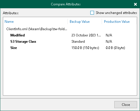

You can also compare attributes of the changed and deleted objects and prefixes against objects and prefixes in the source object storage. To compare them, do the following:
  1. Select a prefix in the items tree in the left pane or an object and the prefix in the right pane. You can use [Ctrl] to select multiple objects and prefixes in the right pane.
  2. Right-click one of the selected items and select Compare > Compare attributes or click Compare Attributes on the ribbon. Alternatively, you can right-click one of the selected items and select Compare > Compare or click Compare with Production on the ribbon.
In the Compare Attributes window, Veeam Backup & Replication shows changed attributes. If you want to show all attributes, click the Show unchanged attributes check box at the top right corner. Note that Veeam Backup & Replication shows attributes maximum for 500 objects and prefixes and shows attributes for the selected objects, not for the nested objects.
