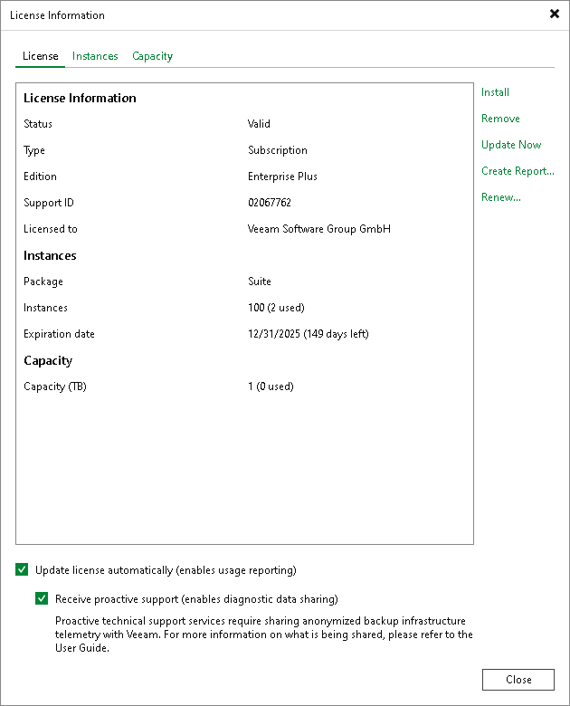

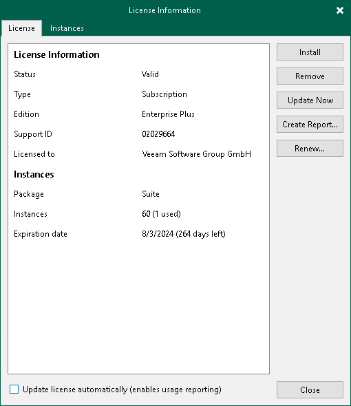

  1. From the main menu, select License.
  2. In the License Information window, click Update Now.
Statistics on the manual license update process is available under the System node in the History view. You can double-click the License key auto-update job to examine session details for the license update operation.
