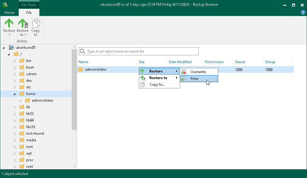

Restoring Files to Original Location
To restore files and folders to the original location, do the following:
  1. Select the necessary files and folders in the file system tree or in the details pane on the right.
  2. Right-click one of the selected items and select one of the following:
  • To overwrite the original files and folders with the ones restored from the backup, select Restore > Overwrite.
  • To save the restored files and folders next to the original ones, select Restore > Keep.
Veeam Backup & Replication will add the RESTORED_YYYYMMDD_HHMMSS postfix to the original names and store the restored items in the same folder where the original items reside.
Alternatively, you can select the same commands on the ribbon.

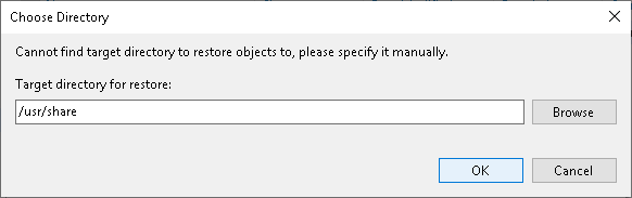

If you restore files from disks that were not mounted to the file system, Veeam Backup & Replication asks for a target directory where to restore the selected files. In this case, file restore to the original location is not possible.

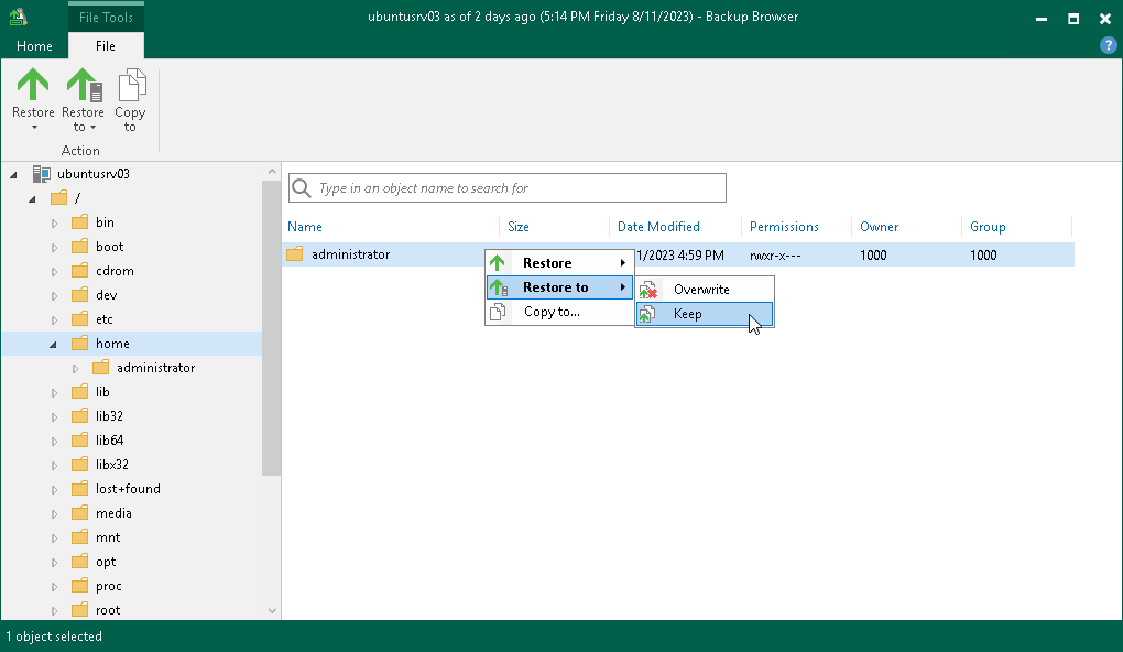

Restoring Files and Folders to New Location
You can restore files and folders to a new machine of the same platform over the network or without the network. This functionality is available for backups of Microsoft Hyper-V VMs created by Veeam Backup & Replication and backups of computers created by Veeam Agent for Linux, Veeam Agent for IBM AIX or Veeam Agent for Oracle Solaris.
To restore files and folders to a new location over the network or without the network, do the following:
  • If you want to overwrite files and folders with identical names in the target location, select Restore to > Overwrite.
  • If you want to keep files and folders with identical names in the target location, select Restore to > Keep.
If there are items with identical names, Veeam Backup & Replication will add the RESTORED_YYYYMMDD_HHMMSS postfix to the original names and store the restored items in the target location.
  1. In the Select Virtual Machine window, select the target workload.
  2. In the Credentials window, provide credentials to connect to the target workload.
  3. In the Choose Directory window, specify a folder where items will be restored.
Note that the browse option is not available for backups created by Veeam Agents.

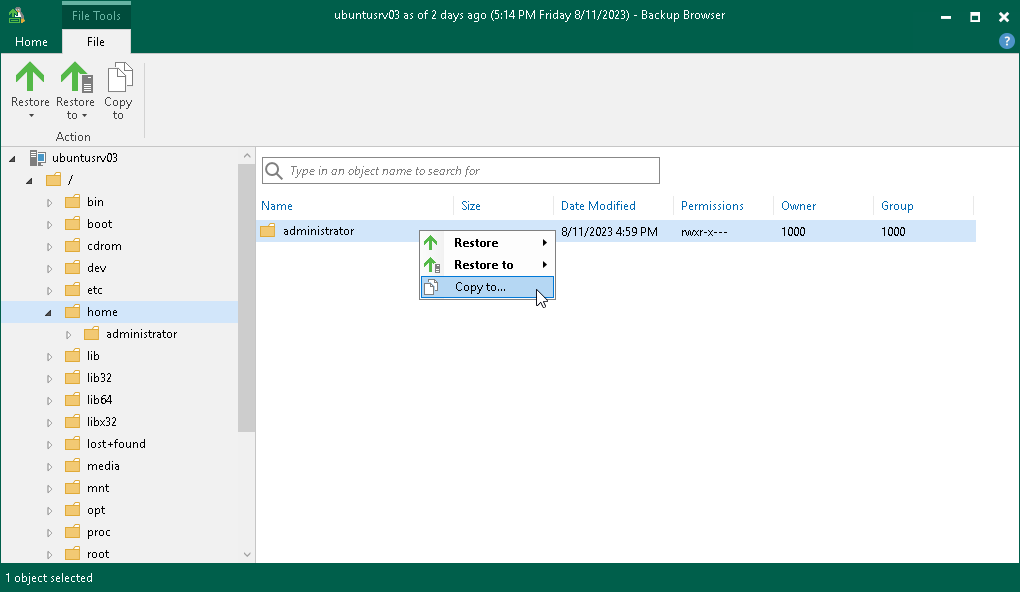

Saving Files and Folders to New Location Over Network
You can restore files and folders to components of the Veeam Backup & Replication infrastructure available over the network.
To save files and folders to a new location over the network:
  2. Right-click one of the selected files or folders and select Copy to.
  3. In the Select Destination window, select the necessary destination:
    • To recover files to a server already added to the Veeam Backup & Replication infrastructure, select the server from the Server drop-down list and then specify the path to a folder where files will be recovered.
    • To recover files to a Linux server that is not added to the Veeam Backup & Replication infrastructure, select Specify a different host from the Server drop-down list and follow the steps of the wizard to add a Linux server that will be used as a target host. The server will be added ad-hoc. Then specify the path to a folder where files will be recovered.
The server you add ad-hoc will not appear in the list of managed hosts in Veeam Backup & Replication: its purpose is to host the files that you recover. It will only remain visible in the Veeam Backup browser until all currently active file-level restore sessions are completed.
Only Linux servers can be added ad-hoc.
    • To recover files to a shared folder, specify a path to the destination folder in the Path to folder field.
  1. If you want to preserve original permissions and ownership for recovered files, select the Preserve permissions and ownership check box in the Select Destination window.
To restore original permissions and ownership settings, the user account you have specified must have privileges to change the owner on the selected server or shared folder.
  1. If prompted, in the Credentials window, specify settings of the user account to access the destination location.

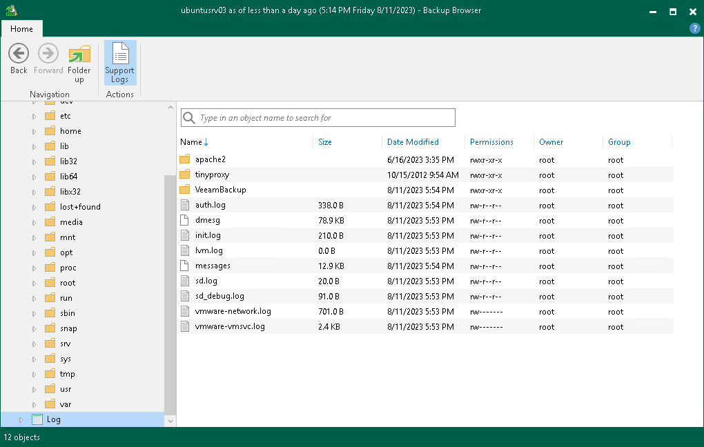

Accessing Helper Appliance Logs
If you need to access logs of the helper appliance, click Support Logs on the Veeam Backup browser ribbon. Veeam Backup & Replication will show the Log node under the file system tree. To hide this node, click Support Logs once again.
