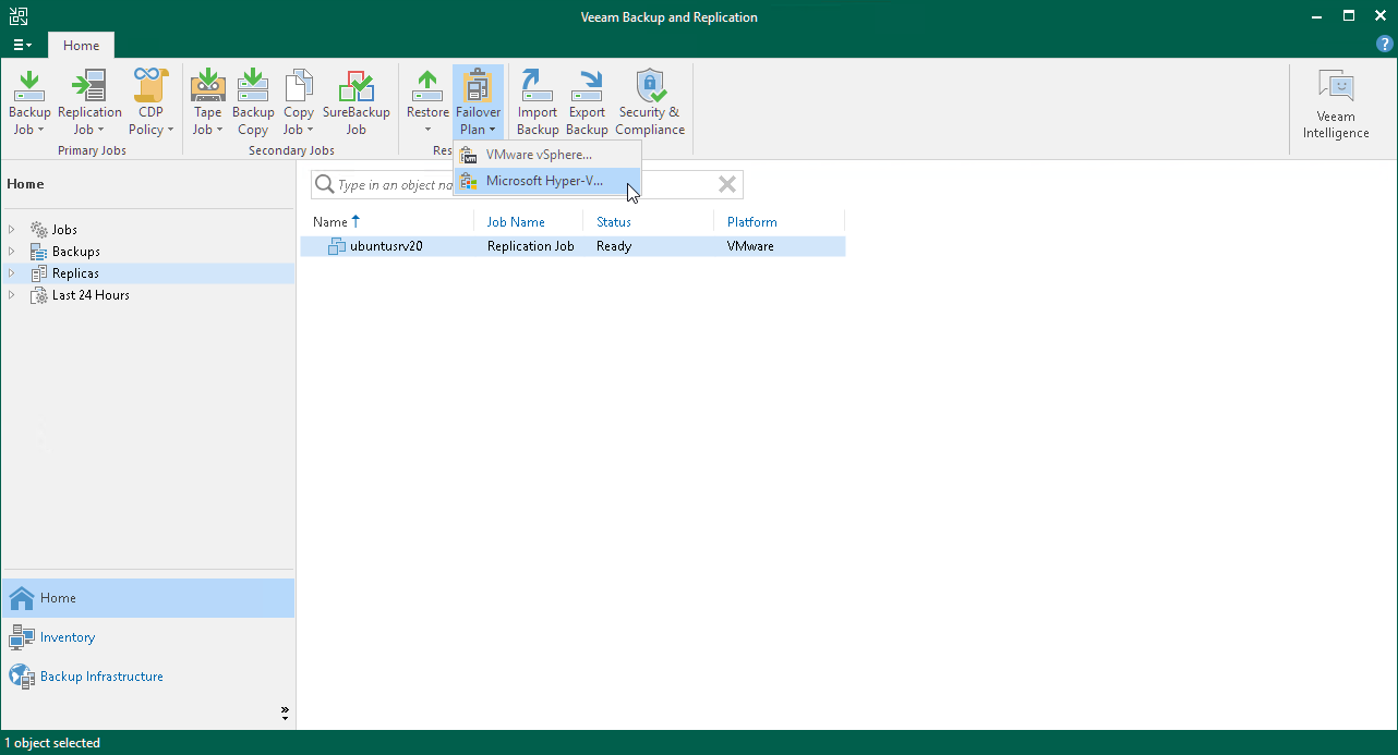

Step 1. Launch New Failover Plan Wizard
To launch the New Failover Plan wizard, do one of the following:
  • On the Home tab, click Failover Plan and select Microsoft Hyper-V.
  • Open the Home view. In the working area, select VMs that you want to add to a failover plan. On the ribbon, click Add to Failover Plan > New failover plan if you want to create a new failover plan, or Add to Failover Plan > <Plan Name> if you want to add VMs to an existing failover plan.
  • Open the Home view. In the working area, select VMs that you want to add to a failover plan and right-click one of them. Select Add to failover plan > New failover plan if you want to create a new failover plan, or Add to failover plan > <Plan Name> if you want to add VMs to an existing failover plan.
Click to zoom in
