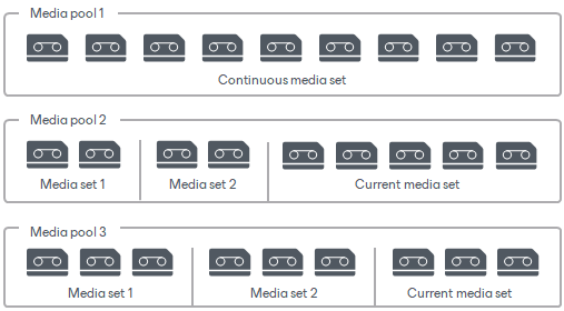

Media sets are used to explicitly distinguish data recorded to particular sets of tapes. You can choose between the following configuration options:
  • Always continuing one media set. Use this option if you do not need to split your tape archives into separate sets of tapes.
  • Creating a new media set for every backup session. In this case, Veeam Backup & Replication will produce a separate set of tapes for each new tape backup session.
  • Starting a new media set for a certain period of time, for example, each week. As a result, you will have a separate set of tapes containing all backups that have been written to tape during a week.
When planning media sets configuration, you should balance between convenient viewing of data and efficiency of using the tapes. Media sets help create distinct packs of tapes, which will be convenient, for example, if you need to bring certain tapes from an offsite storage location to restore data. However, it may use the tapes ineffectively as the new media sets always require a new tape. This option is helpful when you have a lot of backups stored offsite.
Always continuing one media set option is most efficient in terms of tape capacity usage, for the new data will be written to the same tape until it is full. However, in this case the data will be split across tapes and you may require a larger number of tapes to get a particular backup set for restore. This option is usually used in environments where the tapes are not exported from libraries.
