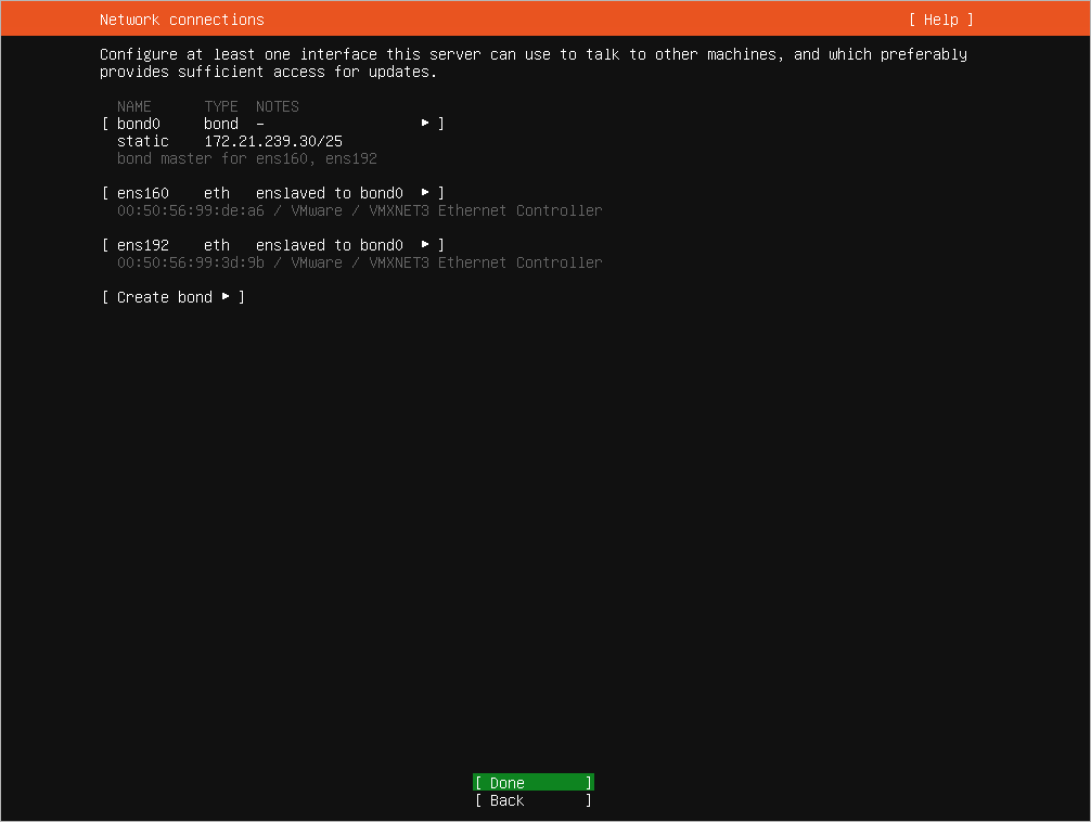

  6. At the Network connections step of the installation wizard, do the following:
  • If you have several network interface cards, create a bond to provide the network failover in case of connection issues. For the bond mode, select one of the following options:
    • balance-rr (if you use EtherChannel without LACP)
    • 802.3ad (if you use EtherChannel with LACP)
    • active-backup (for other configurations)
Example:
Installing Ubuntu Linux Server
  • If you have only one network interface card and cannot create a bond, assign the static IP address to the network interface to reduce the risk of connection issues, for example, with the DHCP server.

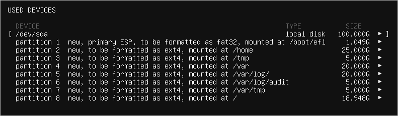

  3. At the Storage configuration step of the installation wizard, follow recommendations from CIS Benchmarks for Ubuntu Linux 20.04 LTS STIG for partitioning.
For the operating system, use the ext4 file system. Example:

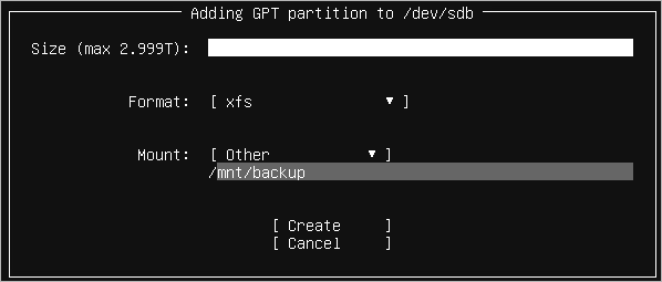

For the backup data, use the XFS file system. Example:
To be compliant with DISA STIG UBTU-20-010414, you do not need to enable disk encryption for the operating system. To protect data in backups, use Veeam Backup & Replication built-in encryption instead. For more information, see Storage Settings.
After you add partitions for all disks, click Continue in the Confirm destructive action window to apply changes. Note that all data on the disks will be deleted.
