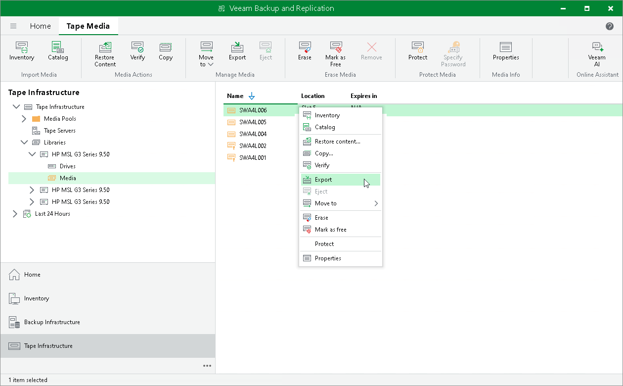

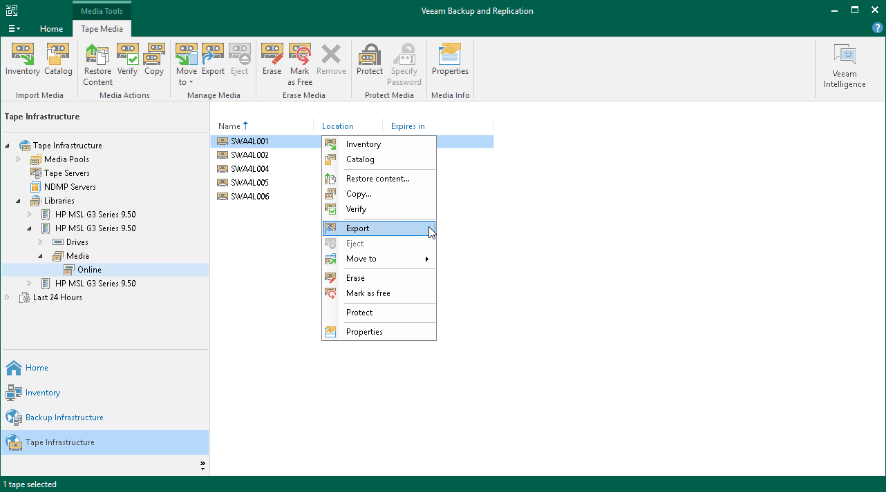

To export a tape:
  1. Open the Tape Infrastructure view.
  2. Navigate to the list of tapes either under Media Pools or under Libraries > LibraryName node > Media > Online.
  3. Select a tape you want to export and click Export on the ribbon. Alternatively, you can right-click selected tape and select Export from the shortcut menu.
You can instruct your tape jobs to export tapes automatically. To do so, navigate to the Options step of backup to tape job or file to tape job and select the Export current media set upon job completion check box.
