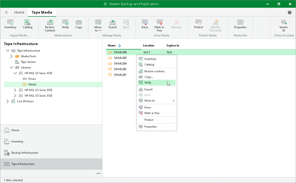

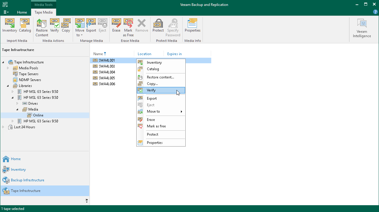

Running Tape Verification
To start the tape verification job:
  1. Open the Tape Infrastructure view.
  2. Navigate to the list of tapes either under Media Pools or under Libraries > LibraryName node > Media > Online.
  3. Select a tape you want to verify and click Verify on the ribbon. Alternatively, you can right-click the selected tape and select Verify from the drop-down menu.
If you want to simultaneously use several drives for tape verification, successively start separate tape verification jobs for different tapes.
