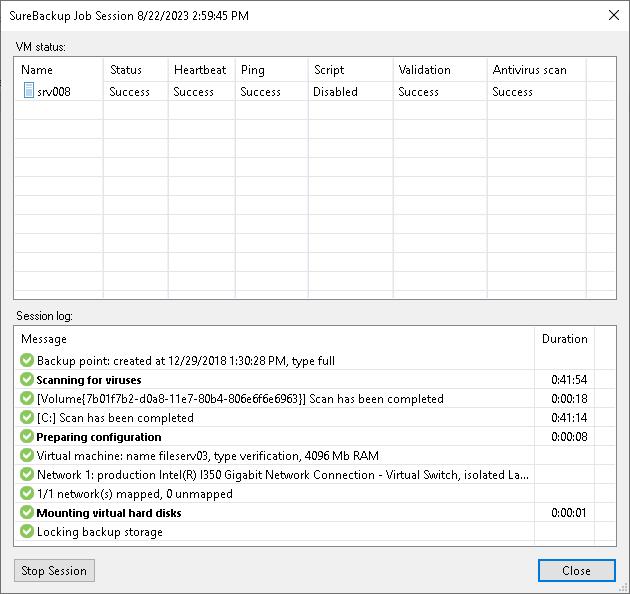

To define whether the script has completed successfully or not, Veeam Backup & Replication publishes the following return codes in the SureBackup job session statistics:
  • 0 — test is passed successfully.
  • 1 — you use a wrong syntax for the script command.
  • 2 — Veeam Backup & Replication is unable to connect to Microsoft SQL Server.
  • 3 — all instances are excluded from the check.
  • 4 — error occurred while Veeam Backup & Replication was getting the list of databases.
  • 5 — unknown error.
  • 6 — one or more databases are not accessible.
Results of script execution are written to the log file located by the following path: %programdata%\Veeam\Backup\<name of the job>\<VM name>_SQLChecker.log. If necessary, you can change the log file location. To do this, pass a new path to the log file in the %log_path% argument in the application group or SureBackup job settings.

The backup file validation test is started after recovery verification tests. As soon as Veeam Backup & Replication completes all "live" verification for all machines in the SureBackup job, it unpublishes machines and starts the backup file validation test.
The result of the backup file validation test impacts the state of the SureBackup job session. If the verification tests are completed successfully but the backup validation is not passed, Veeam Backup & Replication marks the SureBackup job session with the Failed status.
