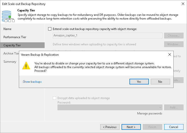

To exclude a capacity extent from the scale-out backup repository scope, do the following:
  2. In the inventory pane, click Scale-out Repositories.
  3. In the working area, select a scale-out backup repository and click Edit Scale-out Repository on the ribbon, or right-click a scale-out backup repository and select Properties.
  4. Move to the Capacity tier step of the wizard.
  5. Clear the Extend scale-out backup repository capacity with object storage check box.
If you have data on the object storage, you will be asked to confirm the action in the dialog box. After that, the object storage repository will be immediately put into the Maintenance mode.
