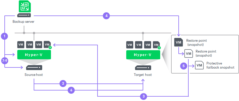

How Failback to Source VM or Already Recovered VM Works
If you fail back to the source VM or an already recovered VM, Veeam Backup & Replicationperforms the following operations:
  1. If the source VM is running, Veeam Backup & Replication powers it off.
  2. Veeam Backup & Replication calculates the difference between disks of the source VM and disks of the VM replica in the Failover state. Difference calculation helps Veeam Backup & Replication understand what data needs to be transported to the source VM to synchronize it with the VM replica.
  3. Veeam Backup & Replication transports changed data to the source VM.
  4. Veeam Backup & Replication powers off the VM replica. The VM replica remains powered off until you commit failback or undo failback.
  5. Veeam Backup & Replication creates a failback protective snapshot for the VM replica. The snapshot acts as a new restore point and saves the pre-failback state of the VM replica. You can use this snapshot to return to the pre-failback state of the VM replica afterwards.
  6. Veeam Backup & Replication calculates the difference between the VM replica and the source VM once again and transports changed data to the source VM. A new synchronization cycle lets Veeam Backup & Replication copy a portion of last-minute changes made on the VM replica while the failback process was being performed.
  7. The state of the VM replica is changed from Failover to Failback. Veeam Backup & Replication temporarily puts replication activities for the source VM on hold.
  8. If you failback to the source VM restored in a new location, Veeam Backup & Replication updates the ID of the source VM in the Veeam Backup & Replication configuration database. The ID of the source VM is replaced with the ID of the restored VM.
  9. If you have selected to power on the source VM after failback, Veeam Backup & Replication powers on the restored source VM on the target host.
