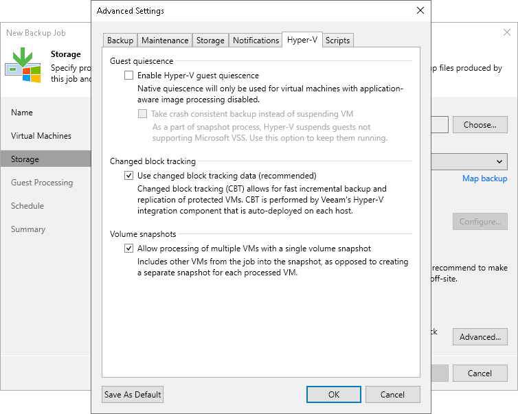

Veeam Backup & Replication enables CBT. You can disable it either at the host level or at the job level for troubleshooting purposes. Note that if you choose to run incremental jobs with CBT disabled, the backup window may increase dramatically, as Veeam Backup & Replication will read all VM data to detect what blocks have changed since the last job session.
