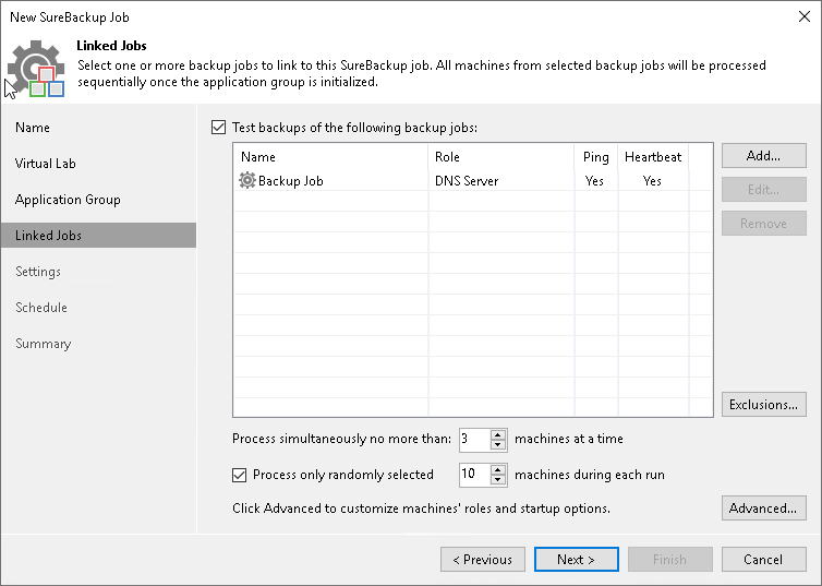

At the Linked Jobs step of the wizard, select backup jobs with machines that you want to verify with the created SureBackup job.
You can link a backup job to the SureBackup job or skip this step. If you do not link a backup job, in Full recoverability testing mode Veeam Backup & Replication will only start machines from the application group in the virtual lab and verify them. You have an option not to link a backup job to the SureBackup job only if you have selected an application group at the Application Group step of the wizard.
Linking Backup Job
To link a backup job to the SureBackup job:
  1. [For full recoverability testing mode] Select the Test backups of the following backup jobs check box.
  2. Click Add.
  3. In the Select Jobs window, select backup jobs.
  4. In the Process simultaneously up to … machines field, specify the maximum number of machines (from a linked job) that can be processed at the same time. For example, if you choose to process three machines at the same time, Veeam Backup & Replication will create three streams — one stream per every verified machine. All three machines will be tested together. But if you choose to process one machine, then only one machine will be tested, and the next machine will be processed in the available stream. In Full recoverability testing mode, after all machines are verified, machines from the application group will be powered off or will be left running (if the Keep the application group running after the job completes option has been enabled at the Application Group step of the wizard).
  5. Select Process only randomly selected ... machines during each run check box and specify the maximum number of machines you want to randomly test.
