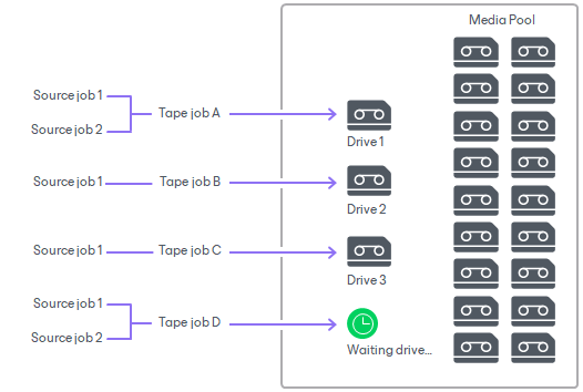

When you process tape jobs in parallel, the media pool assigns a drive to each running tape job. For example, if you set three drives as the maximum, you can process up to three tape jobs at the same time. If you have more jobs running at the same time, they are queued. When one of the jobs finishes and releases its drive, the first queued job takes the drive.
To enable this mode, select the Enable parallel processing for tape jobs using this media pool check box in optional media pool settings. If this mode is enabled in media pool settings, for machine backup to tape jobs you can limit the number of drives the job can use, as described in section Specify Archiving Options.
This option is available for backup to tape and file to tape jobs.
For example:
  • You set the maximum number of drives to three.
  • Four tape jobs start at the same time.
The tape jobs start, and jobs A, B and C occupy three drives to write data to tape. Tape job D is queued and waits. When one of the jobs finishes and releases its drive, tape job D takes the drive and starts writing data.

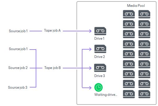

Example 1. Processing Two Tape Jobs with Multiple Source Jobs
  • Tape job A has one source job; tape job B has three source jobs. Both tape jobs start at the same time.
Tape job A occupies drive 1. Tape job B occupies two other available drives and processes two source jobs. Tape job A finishes and releases drive 1, the third source job from tape job B occupies drive 1.
The order in which VMs are queued for processing is defined by the schedule configured for running tape jobs and the order of source jobs within each tape job. Within each source job, VMs are processed in alphabetical order.

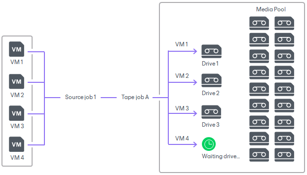

Example 2. Processing One Tape Job with One Source Job for Four VMs
  • Tape job A has one source job, the source job processes four VMs.
Tape job A starts and occupies all three available drives. It writes each separate VM of the source job by a separate drive. After tape job A finishes writing one of the current VMs and releases one of the three available drives, it occupies this drive with writing VM4. In other words, if a job with per-machine chains is configured to process more VMs than there are drives available, it occupies the entire media pool.
VMs are queued for processing in alphabetical order.

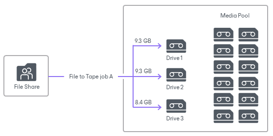

Example 3. Processing One File to Tape Job
For backup to tape for unstructured data backups and file to tape jobs, Veeam Backup & Replication divides the data into backup sets, each to be written by a separate drive.
The size of the backup set is determined by either one of the following conditions:
  • Maximum size of data is 9.3 GB.
  • Maximum number of objects is 1,000,000 (includes objects to be backed up, objects deleted from disk and folders that require a version update).
  • Maximum number of enumeration blocks is 50,000 (an enumeration block is one folder with its first level subfolders).
In the example, the following settings apply:
  • File to Tape job A has 50,000 files to process, the total size of data is 27 GB.
File to Tape job A starts and occupies all three available drives. Veeam Backup & Replication divides the data into three backup sets based on their size: drive 1 and drive 2 write 9.3 GB each, while drive 3 writes the remaining 8.4 GB of data to tape.
