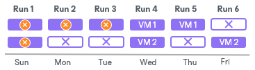

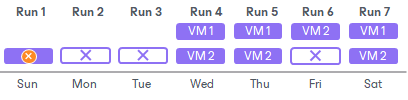

For example, a backup job processes 2 VMs: VM 1 and VM 2. According to the retention policy settings, the backup chain must contain 3 restore points. The backup job ran 3 times and VMs were processed in the following way:
  • VM 1 was successfully backed up 3 times and has 3 restore points.
  • VM 2 was not backed up in 2 job sessions and has 1 valid restore point.
Removal of Restore Points
During the 4th job run, Veeam Backup & Replication will create new restore points for VM 1 and VM 2 — full backups. However, Veeam Backup & Replication will not remove the earliest restore point. Veeam Backup & Replication will wait until a full backup file and 2 incremental backup files are present in the backup chains of each VM. After that, Veeam Backup & Replication will remove the whole outdated backup chain from the backup repository. During the 5th job run, Veeam Backup & Replication will create a new restore point for VM 1 and VM 2.

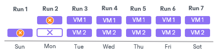

During the 6th job run, the processing of VM 2 will fail. Veeam Backup & Replication will remove the earliest restore points only of VM 1 because the number of restore points for VM 1 in the active backup chain equals 3 — a full backup file and 2 incremental backup files. The number of restore points in the active backup chain of VM 2 is not sufficient to remove restore points.
During the 7th job run, Veeam Backup & Replication will create restore points for VM 1 and VM 2. Veeam Backup & Replication will remove the earliest restore points only for VM 2 because a new backup chain is not started for VM 1 and the number of restore points for VM 2 in the active backup chain equals 3 — a full backup file and 2 incremental backup files.

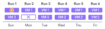

For example, a backup job processes two VMs: VM 1 and VM 2. According to the retention policy settings, the backup chain must contain 5 restore points. The backup job ran 5 times and VMs were processed in the following way:
  • VM 1 was successfully backed up 5 times and has 5 valid restore points.
  • VM 2 was not backed up in 1 job session and has 4 valid restore points.
During the 6th job run, Veeam Backup & Replication will create restore points for VM 1 and VM 2. Veeam Backup & Replication will remove the earliest restore point of VM 1 because the number of restore points in the backup chain exceeds 5.

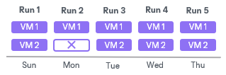

During the 7th job run, Veeam Backup & Replication will create restore points for VM 1 and VM 2. Veeam Backup & Replication will remove the earliest restore points of VM 1 and VM 2 because the number of restore points in the backup chain of each VM exceeds 5.

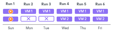

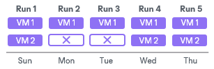

When Veeam Backup & Replication adds a new restore point to the backup chain, it will not remove the earliest restore point. Veeam Backup & Replication will wait until a new full backup file and 2 incremental backup files are added to the backup chain. After that, it will remove the whole outdated backup chain from the backup repository. Restore points in the new backup chain, at the same time, may contain data for both VMs or for one VM only: Veeam Backup & Replication regards backup files as restore points, not separate VMs in these files.

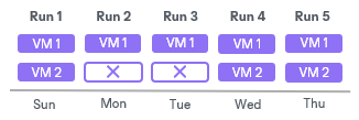

  • VM 2 was not backed up in 2 job sessions and has 3 valid restore points.
After that, Veeam Backup & Replication will run a new backup job session in which VM 1 and VM 2 will be successfully processed. When a new restore point is added to the chain, Veeam Backup & Replication will remove the earliest restore point because the number of restore points in the backup chain exceeds 5. As a result, you will have 5 restore points for VM 1 and 3 restore points for VM 2.
