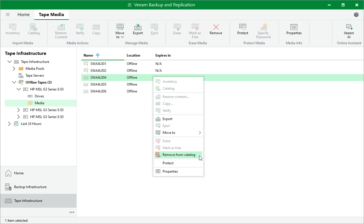

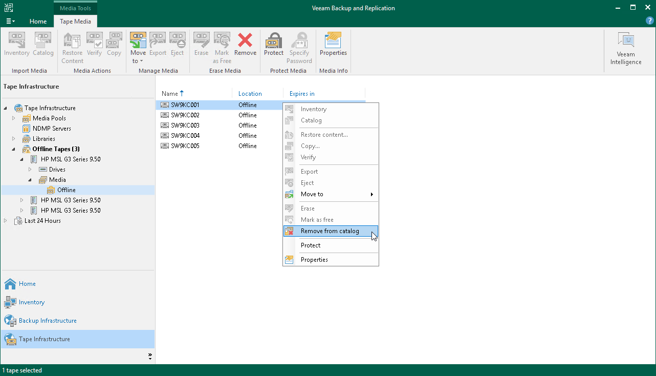

  1. Open the Tape Infrastructure view.
  2. Navigate to the list of tapes either under Media Pools or under Libraries > LibraryName node > Media > Offline.
  3. Select offline tapes you want to remove from the catalog and click Remove on the ribbon. Alternatively, you can right-click selected tapes and select Remove from catalog from the shortcut menu.
  4. In the opened dialog box, click Yes to confirm removal.
