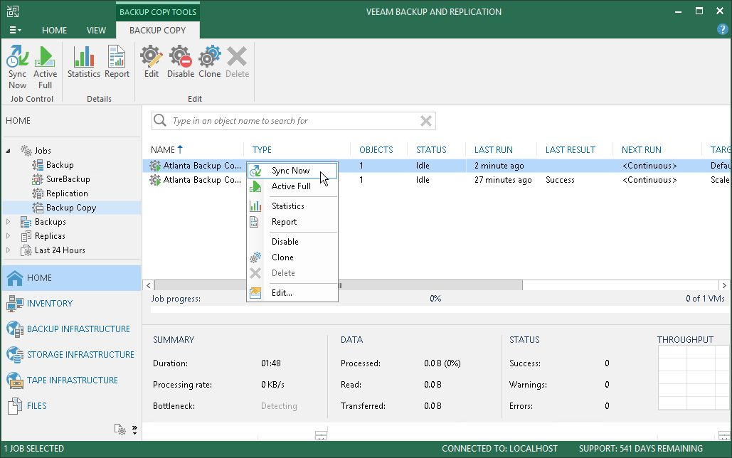

To start a new data backup copy interval manually:
  1. Open the Home view.
  2. In the inventory pane, select the Backup Copy node under Jobs.
  3. In the working area, select the backup copy job and click Sync Now on the ribbon or right-click the backup copy job and select Sync Now.
Click to enlarge
