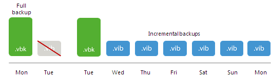

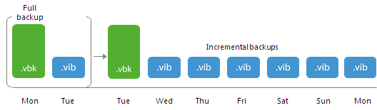

- As the allowed number of restore points is exceeded, Veeam Backup & Replication transforms the backup chain. The transformation process slightly differs from a regular one. Veeam Backup & Replication does not inject data from the incremental backup to the full backup. Instead, it copies data from full and incremental backups and stores them to a new full backup file, next to the primary backup file.
- The incremental backup from which data was copied is removed as obsolete.

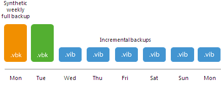

- The primary full backup file remains on the target backup repository. Veeam Backup & Replication sets it aside and marks it as a weekly full backup. The weekly backup is no longer used in the backup chain.
- The newly created full backup file remains in the backup chain and is used as a starting point for incremental backups created by the regular backup cycle.
For example, weekly backup is scheduled on Monday. Veeam Backup & Replication will keep transforming the backup chain until the full backup file reaches Monday. During the next backup copy interval, Veeam Backup & Replication will transform the backup chain. To do that, it will copy data from the Monday full backup and Tuesday incremental backup to a new full backup file and store it next to the primary full backup file.
As a result, on the target backup repository you will have a full backup created on Monday and a backup chain that includes a full backup as of Tuesday and a chain of increments Wednesday through Monday. The full backup as of Monday will be marked as a weekly backup and set aside. The full backup as of Tuesday will be used as a new starting point in the backup chain.
