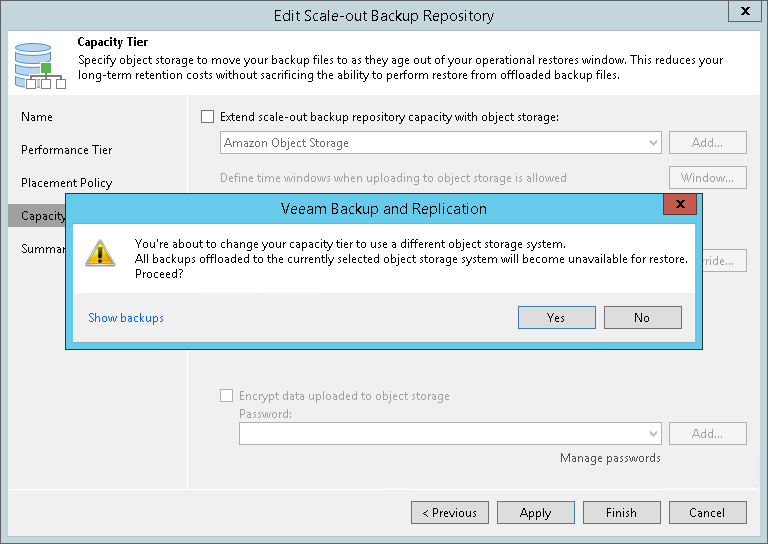

To exclude an object storage repository from the scale-out backup repository scope, do the following:
- Open the Backup Infrastructure view.
- In the inventory pane, click Scale-out Repositories.
- In the working area, select a scale-out backup repository and click Edit Scale-out Repository on the ribbon or right-click a scale-out backup repository and select Properties.
- Move to the Capacity tier step of the wizard.
- Deselect the Extend scale-out backup repository capacity with object storage check box.
You will be asked to confirm the action in the dialog shown below, whereupon an object storage repository will be immediately put into maintenance mode.
