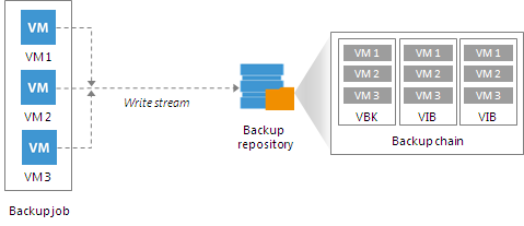

By default, backup jobs write VM data to the backup repository in one write stream, and store data of all VMs to the same backup file. Such behavior can be non-optimal if the target storage device is able to write data in multiple streams simultaneously. In this situation, the backup repository may become the bottleneck for the data transfer, even though its resources will not be fully utilized.

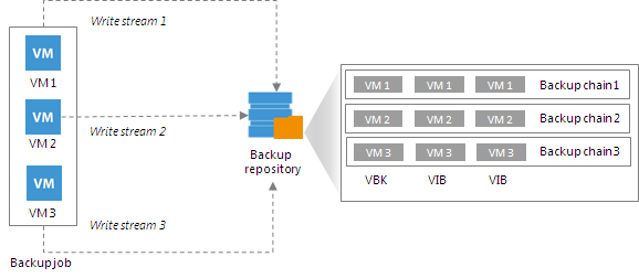

You can instruct Veeam Backup & Replication to create per-VM backup files on the backup repository. In this case, the backup job will use a separate write stream for every VM in the job, and store data of every VM to a separate backup file. Resources of the storage device will be used more efficiently, and the job performance may increase.

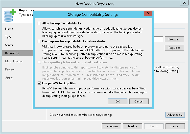

To create per-VM backup files, you must enable the Use per-VM backup files option at the level of the backup repository. It is recommended that you enable this option for deduplicating storage appliances that support multiple write streams. The option is also enabled for scale-out backup repositories by default.

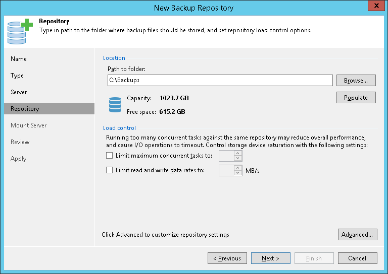

It is not recommended that you disable the Limit maximum concurrent tasks to N option for backup repositories with per-VM backup chains. In case of per-VM backup chains, synthetic operations (synthetic full backup, backup files merge and transform) work in parallel for every VM in the backup. The number of parallel operations is limited by the number of concurrent tasks that can be performed on the backup repository. If you disable the Limit maximum concurrent tasks to N option (which results in using an unlimited number of slots), the load on the backup repository may be high. |

- The Use per-VM backup files option cannot be enabled for backup repositories with rotated drives.
- If you enable the Use per-VM backup files option, data deduplication between VMs will not work. For more information, see Data Compression and Deduplication.
- The Per-VM backup chains functionality is available in Veeam Backup & Replication Enterprise Edition and higher. If you configure backup repositories to produce per-VM backup chains and then install a license that does not support this functionality, you must manually disable the Use per-VM backup files option for backup repositories. Otherwise backup jobs targeted at these backup repositories will be failing.
