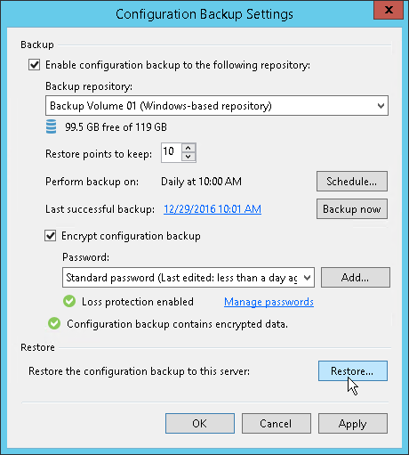

- On the target backup server, from the main menu, select Configuration Backup.
- In the Restore section, click Restore to launch the Configuration Database Restore wizard.

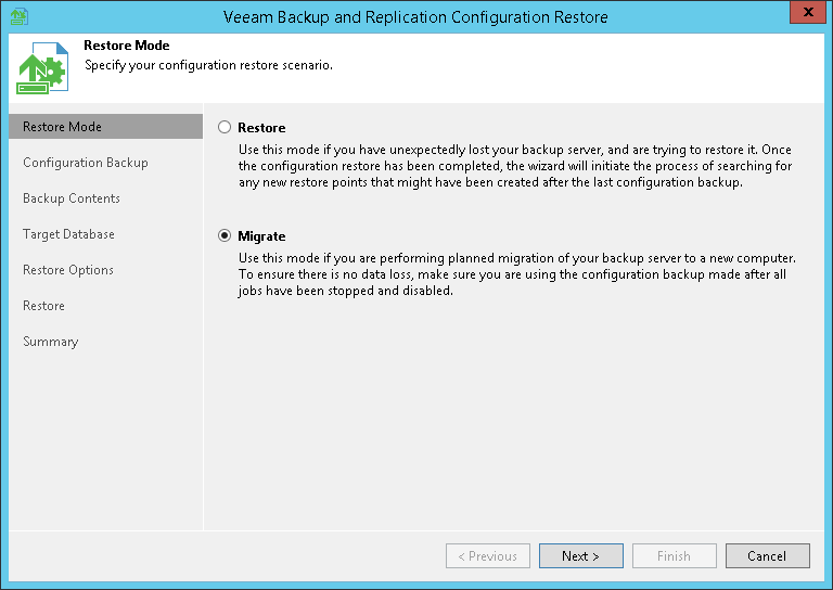

- At the Restore Mode step of the wizard, select Migrate.
- Follow the next steps of the wizard. Specify the configuration settings as described in the steps of Restoring Configuration Database.
