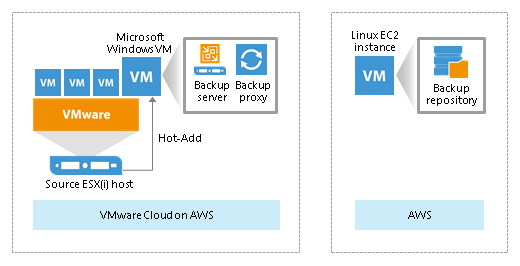

Simple Deployment
Simple deployment is preferable for VMware Cloud on AWS environments with low traffic load. Per this deployment type, you can install the backup server and the backup proxy on the same VM.
In a simple VMware Cloud on AWS deployment the backup infrastructure includes the following components:
- Source ESXi host
- Veeam backup server
- Veeam backup proxy
- Veeam backup repository: a Linux-based EC2 instance in AWS

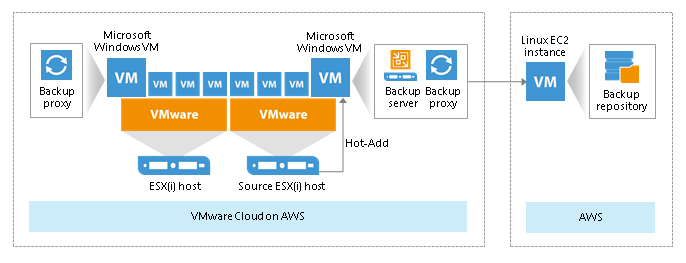

Advanced Deployment
Advanced deployment is intended for large-scale VMware Cloud on AWS environments with a large number of backup and replication jobs. Per this deployment type, it is recommended to install several backup proxies on dedicated VMs to move the workload from the backup server.
In an advanced VMware Cloud on AWS deployment the backup infrastructure includes the following components:
- Source ESXi host
- Several Veeam backup proxies for better performance and workload distribution
To increase scalability and optimize performance in an advanced deployment, follow the recommendations below:
- Deploy additional backup proxies.
- Scale accordingly CPU and RAM resources of the EC2 instance used as a backup repository. Make sure it has enough free space for storing backups.

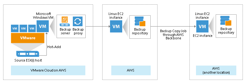

Deployment Scenarios for Offsite Backup
To keep up with the 3-2-1 backup rule, it is recommended that you have a copy of your backups in an offsite location. To transfer your backups offsite, you can leverage Veeam backup copy.
Mind that transferring backups over the Internet may require paying additional fees. As a cost-effective alternative, you can store backups in a different AWS geographical location. In this case, backup copies are transferred through the AWS backbone. Using such AWS network solution provides data transfer at lower latency and cost when compared to the public Internet.
To perform backup copy to a different AWS location, the backup infrastructure must contain the following components:
- Source ESXi host
- Veeam backup repository for backup copy: a Linux-based EC2 instance in another AWS location
As an offsite backup solution, you can copy backups to virtual tapes and store them in Amazon S3/Glacier cloud storage. In this case, AWS Storage Gateway performs the role of a Virtual Tape Library (VTL). |
