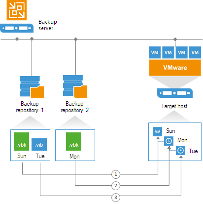

For example, you have configured two backup jobs that process the same VM, and targeted these jobs at two different backup repositories. The backup jobs have created the following backup files:
  • Backup job 1 has created 2 restore points in Backup repository 1: full backup file on Sunday and incremental backup file on Tuesday.
  • Backup Job 2 has created 1 restore point in Backup repository 2: full backup file on Monday.
The replication job is configured to retrieve VM data from backups and scheduled to run daily. In this case, the replication job will retrieve VM data from backups in the following way:
  1. On Sunday, the replication job will retrieve VM data from the full backup file in Backup repository 1.
  2. On Monday, the replication job will retrieve VM data from the full backup file in Backup repository 2.
  3. On Tuesday, the replication job will retrieve VM data from the incremental backup file in Backup repository 1.
