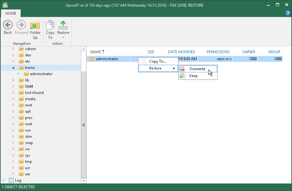

Restoring Files to Original Location
To restore files and folders to the original location, in the Veeam Backup browser right-click a file or folder and select one of the following commands:
  • To overwrite the original file on the VM guest OS with the file restored from the backup, select Restore > Overwrite.
  • To save the file restored from the backup next to the original file, select Restore > Keep.
Veeam Backup & Replication will add the .RESTORED-YYYYMMDDHHMMSS suffix to the original file name and store the restored file in the same folder where the original file resides.
To access the target VM guest OS and restore files to the original location, Veeam Backup & Replication uses an account specified in the backup job settings. If this account does not have sufficient rights to access the target VM guest OS, you will be prompted to enter credentials. In the Credentials window, specify a user account to access the destination location (server or shared folder). You can use the account under which you are currently logged on or a different account.

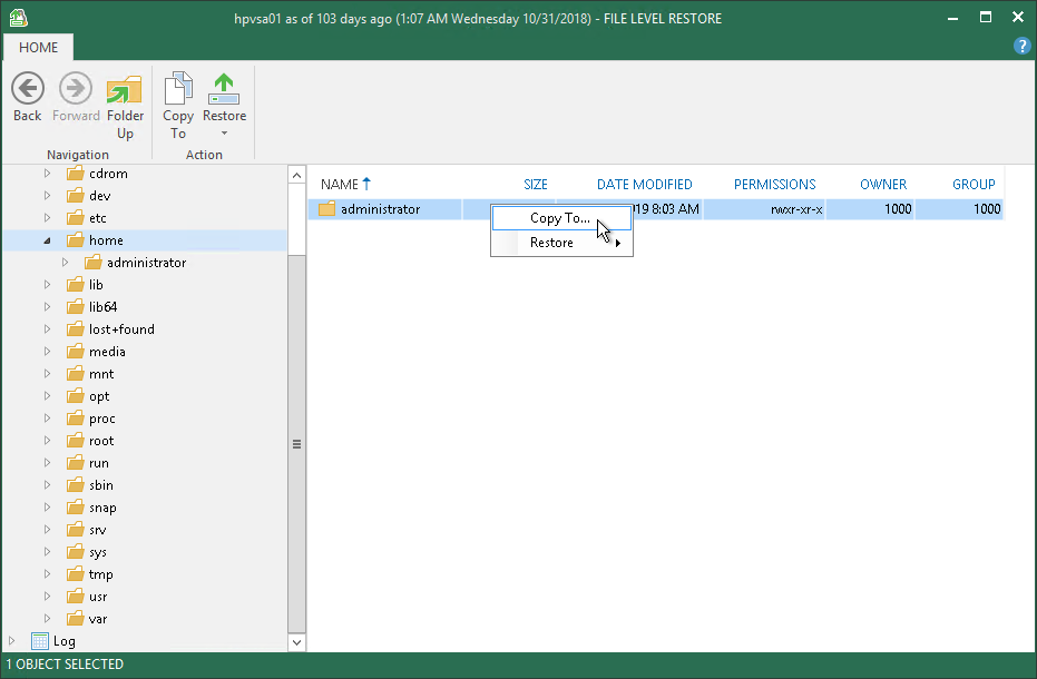

Saving Files to New Location
To save files and folders to a new location:
  1. In the Veeam Backup browser, right-click the necessary file or folder and select Copy to.
  2. In the Select Destination window, select a destination server (local or remote) from the list or provide a path to a shared folder.
    • If you are recovering files to a Linux server, you can select the destination server from the list or add the destination server ad-hoc. To add a destination server ad-hoc, scroll down the list of servers and choose Specify a different host at the end of the list. Follow the steps of the wizard to add a Linux server that will be used as the destination server.
The server you add ad-hoc will not appear in the list of managed hosts in Veeam Backup & Replication: its purpose is to host files that you recover. The added server will only remain visible in the Veeam Backup browser until all currently active file-level restore sessions are completed.
    • If you are recovering files to a shared folder, specify a path to the destination folder.
  1. If you want to preserve original permissions and ownership for recovered files, select the Preserve permissions and ownership check box.
  2. After you click Restore, you may need to specify credentials to access the destination location. If prompted, in the Credentials window specify the user account to access the target server or shared folder. You can use the account under which you are currently logged on or a different account.
