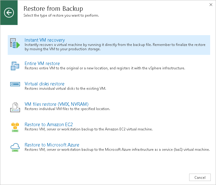

Step 1. Launch Instant VM Recovery Wizard
To launch the Instant VM Recovery wizard, do one of the following:
- On the Home tab, click Restore > VMware vSphere > Restore from backup > Entire VM restore > Instant VM recovery.
- Open the Home view. In the inventory pane, select Backups. In the working area, expand the necessary backup and do one of the following:
- Select the VM that you want to restore and click Instant VM Recovery on the ribbon.
- Right-click the VM that you want to restore and select Instant VM recovery.
