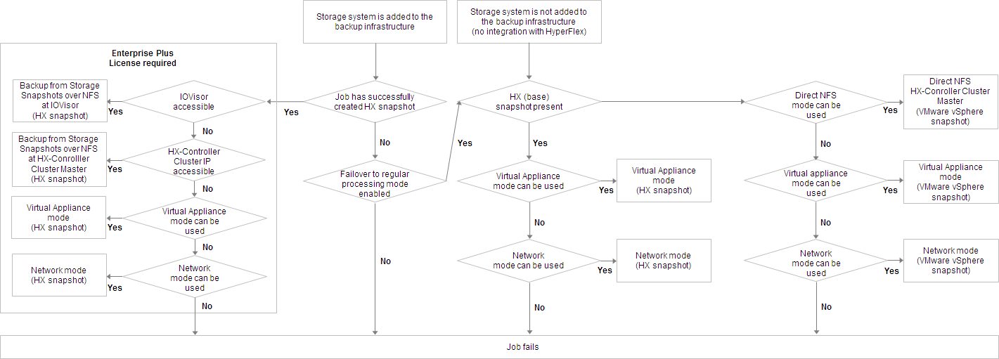

You can instruct Veeam Backup & Replication to read data from Cisco HyperFlex snapshots in the following transport modes: Direct storage access, Virtual appliance or Network. The recommended mode is Direct storage access working over NFS protocol. It provides the best performance and low overhead on ESXi hosts. In this mode, Veeam Backup & Replication bypasses the ESXi host and reads/writes data directly from/to Cisco HyperFlex NFS data network.

- Backup data read over NFS is processed by a single HyperFlex Controller that holds the HyperFlex Controller Cluster IP.
If these requirements are not met, Veeam Backup & Replication can process VM data in the Virtual appliance or Network transport mode.
The diagram below demonstrates how Veeam Backup & Replication picks transport modes for processing VMs hosted on Cisco HyperFlex:
