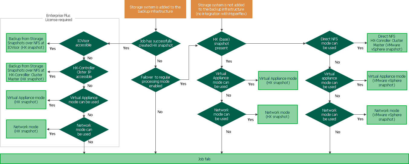

The diagram below demonstrates how Veeam Backup & Replication picks transport modes for processing VMs hosted on Cisco HyperFlex:
