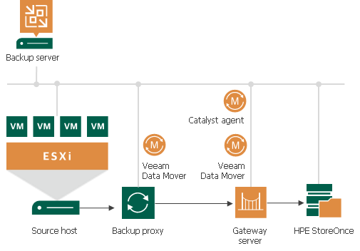

HPE StoreOnce Deployment
To communicate with HPE StoreOnce, Veeam Backup & Replication uses two Data Mover Services that are responsible for data processing and transfer:
- Veeam Data Mover on the backup proxy
- Veeam Data Mover on the gateway server
The HPE StoreOnce storage cannot host Veeam Data Mover Service. For this reason, to communicate with the HPE StoreOnce storage, you need to deploy a gateway server. Veeam Backup & Replication will automatically deploy a Veeam Data Mover on this gateway server. For more information, see Gateway Server. For communicating with the HPE StoreOnce storage appliances, the gateway server must run a 64-bit Microsoft Windows version.
When any job addresses the backup repository, the Data Mover Service on the gateway server establishes a connection with the Data Mover Service on the backup proxy, enabling efficient data transfer over LAN or WAN.
The gateway server is selected when you assign a backup repository role to the HPE StoreOnce appliance. You can define the gateway server explicitly or instruct Veeam Backup & Replication to select it automatically.
For work with HPE StoreOnce, Veeam Backup & Replication uses the Catalyst agent installed on the gateway server. If you want to reduce the load on the network between the source and target side, assign the gateway server role to a machine on the source side, closer to the backup proxy. |
