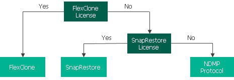

Depending on the operation mode of the NetApp storage system, Veeam Backup & Replication uses different technologies to create a clone of an NFS share.
7-mode
If the NetApp storage system operates in the 7-mode, you must have a FlexClone or SnapRestore license installed, or the NDMP protocol enabled.
Veeam Backup & Replication uses the following technologies for LUN clone creation:
  • If you have a FlexClone license installed, Veeam Backup & Replication uses the FlexClone technology.
  • If you have a SnapRestore license installed, Veeam Backup & Replication uses the SnapRestore technology.
If neither FlexClone nor SnapRestore license is installed, Veeam Backup & Replication uses the NDMP protocol. If the NDMP protocol is not enabled, VM data restore will fail.
NFS ProtocolImportant!
[For Instant VM Recovery] Veeam Backup & Replication performs actual Instant VM Recovery only if a FlexClone license is installed. If the SnapRestore license is installed or the NDMP protocol is enabled, Veeam Backup & Replication performs entire VM restore instead of Instant VM Recovery. As a result, the restore process takes more time.

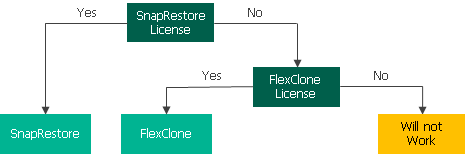

Restore from SnapVault
7-mode
  • If a SnapRestore license is not installed, Veeam Backup & Replication uses the NDMP protocol. If the NDMP protocol is not enabled, VM data restore will fail.
[For Instant VM Recovery] If you restore data from NetApp SnapVault, Veeam Backup & Replication performs entire VM restore instead of Instant VM Recovery. As a result, the restore process takes more time.
NFS Protocol
C-mode
If the NetApp storage system operates in the C-mode, you must have a FlexClone license installed. In the opposite case, VM data restore will fail.
