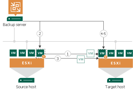

When you start the planned failover, Veeam Backup & Replication performs the following steps:
- The failover process triggers the replication job to perform an incremental replication run and copy the un-replicated changes to the replica.
- The guest OS of the VM is shut down or the VM is powered off.
If VMware Tools are installed on the VM, Veeam Backup & Replication tries to shut down the VM guest OS. If nothing happens after 15 minutes, Veeam Backup & Replication powers off the VM. If VMware Tools are not installed on the VM or the VM is suspended, Veeam Backup & Replication powers off the VM.
- The failover process triggers the replication job to perform another incremental replication run and copy the portion of last-minute changes to the replica. The replica becomes fully synchronized with the source VM.
- The VM is failed over to its replica.
- The VM replica is powered on.
