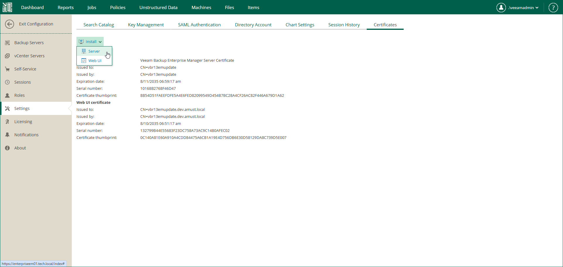

To install a new certificate, follow these steps:
  1. Log in to Enterprise Manager using an account with the Portal Administrator role.
  2. In the upper-right corner, click Configuration.
  3. Open the Settings section.
  4. On the Certificates tab, click Install and then choose the type of certificate to install:
  • Select Server to install the certificate that the Veeam Backup Enterprise Manager Service and Veeam Guest Catalog Service use to connect to backup servers. This certificate is also used by the Veeam Backup Enterprise Manager REST API.
  • Select Web UI to install the certificate that the Veeam Backup Enterprise Manager web app, Veeam Plug-in for VMware vSphere Client, and Veeam Plug-in for VMware Cloud Director use to connect to the web browser.

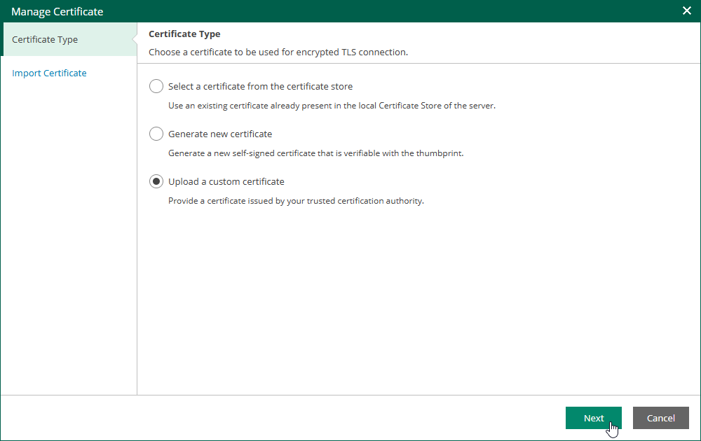

  1. At the Certificate Type step of the Manage Certificate wizard, select one of the following options:
  • Select Select a certificate from the certificate store to use a certificate that is already uploaded to the local Certificate Store.
  • Select Generate new certificate if you want Enterprise Manager to generate a self-signed certificate.
  • Select Upload a custom certificate to upload a certificate signed by your trusted Certificate Authority (CA). For more information on internal CA certificates, see Using Certificate Signed by Internal CA.

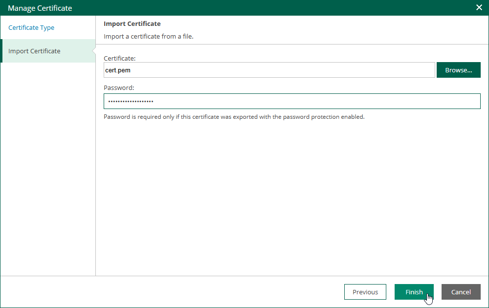

Enterprise Manager accepts only PEM files that contain exactly two key sections: the private key and the server certificate. If the file contains multiple certificates, the upload fails with the following error: PEM contains multiple public key sections. In this case, keep only the private key and the server certificate in the PEM file, and remove all other certificates. Add intermediate certificates separately to the certificate store on the connected backup servers.
Installing Certificates
  1. At the next step of the wizard, either provide a certificate friendly name for a self-signed certificate or choose an existing certificate that you want to install.
  1. To install the certificate, click Finish.
