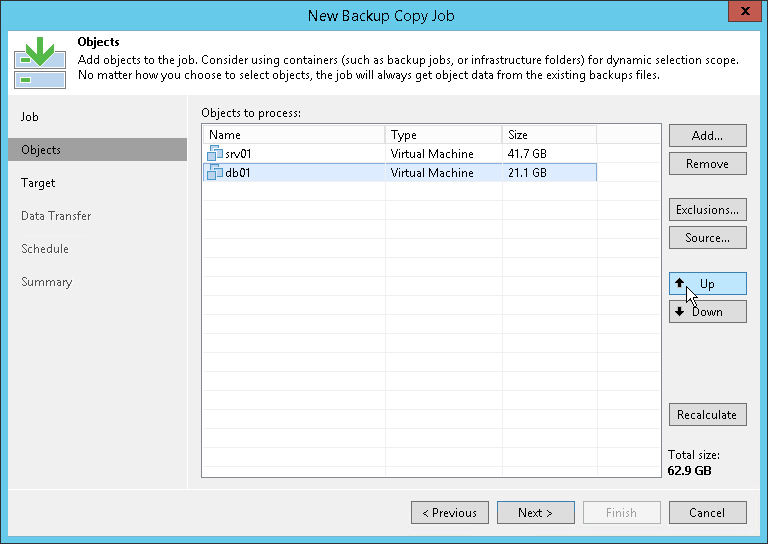

To define workload processing order:
- At the Objects step of the wizard, select a workload whose order you want to change.
- Use the Up and Down buttons on the right to move the workload up or down in the list.
