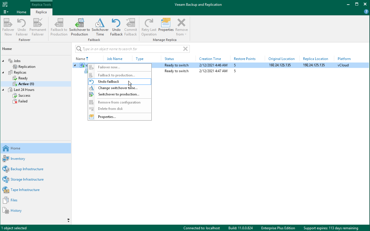

To undo failback:
  1. Open the Home view.
  2. In the inventory pane, navigate to the Replicas > Active node.
  3. In the working area, select the necessary replica and click Undo Failback on the ribbon. Alternatively, you can right-click the necessary replica and select Undo Failback.
If the undo failback operation failed, you can retry this operation again. To perform a retry, in the working area, select the necessary vApp and select Retry Undo Failback on the ribbon. Alternatively, you can right-click the necessary vApp and select Retry undo failback.
