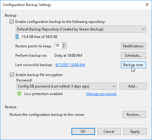

Step 2. Create Configuration Database Backup
To create a configuration database backup manually, perform the following steps:
- From the main menu of the Veeam Backup & Replication console, select Configuration Backup.
- Make sure that the Enable configuration backup to the following repository check box is selected.
- From the list of repositories, select a backup repository in which the configuration backup must be stored.
- Click Backup now.

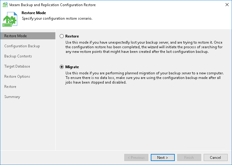

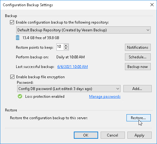

Step 3. Restore Configuration Database from Backup
To restore the configuration database, perform the following:
- In the Restore section, click Restore.
- At the Restore Mode step of the Veeam Backup & Replication Configuration Restore wizard, select Migrate.
- Complete the wizard as described in the Restoring Configuration Database section.
