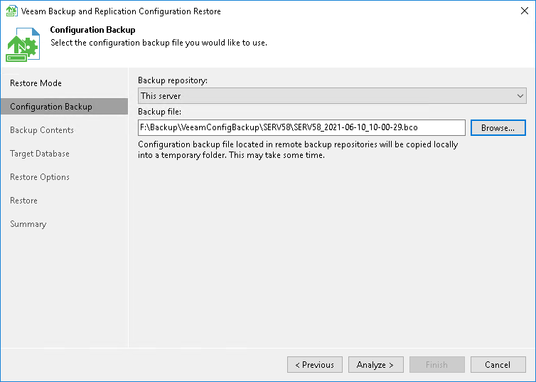

- At the Configuration Backup step of the wizard, specify the backup file of the configuration database
- From the Backup repository drop-down list, select This server.
- Click Browse to specify the backup file location.
Note |
This backup file has been created in Step 3. You must copy the backup file to the target Veeam Backup & Replication server beforehand. |
