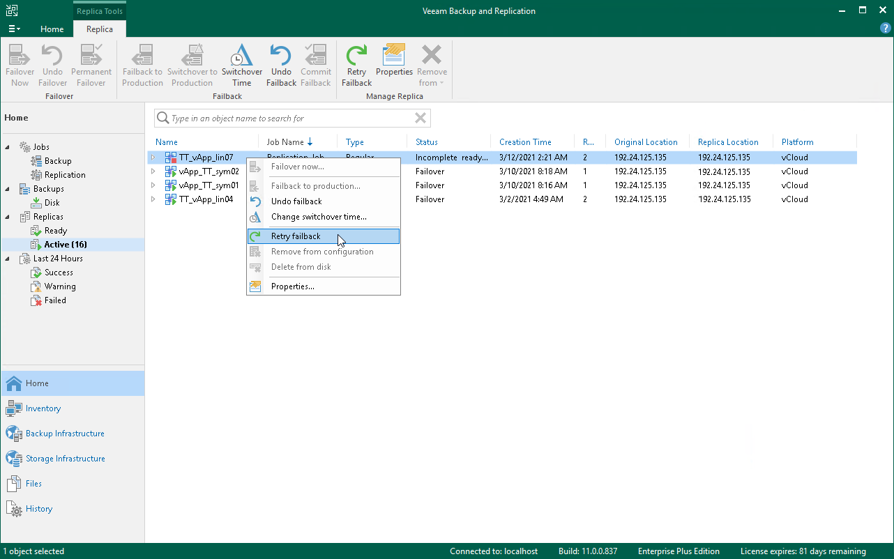

To retry failback:
- Open the Home view.
 - In the inventory pane, navigate to the Replicas > Active node.
 - In the working area, select the necessary vApp and select Retry Failback on the ribbon. Alternatively, you can right-click the necessary vApp and select Retry failback.
