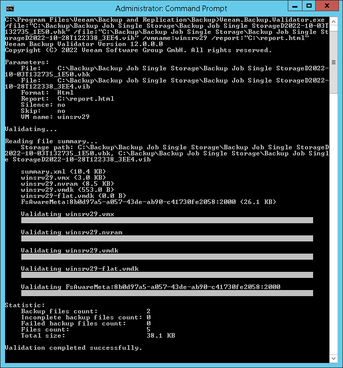

Example 1
This command validates the winsrv29 VM in the incremental backup file and writes the results in the report.html file.
Veeam.Backup.Validator.exe /file:"C:\Backup\Backup Job Single Storage\Backup Job Single StorageD2022-10-03T132735_1E50.vbk" /file:"C:\Backup\Backup Job Single Storage\Backup Job Single StorageD2022-10-28T122338_3EE4.vib" /vmname:winsrv29 /report:"C:\report.html" |

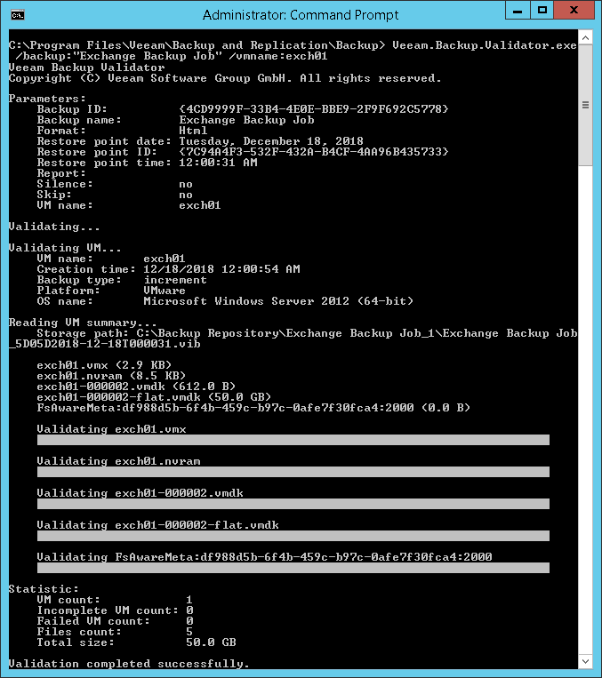

Example 2
This command validates the exch01 VM in the Exchange Backup Job file.
Veeam.Backup.Validator /backup:"Exchange Backup Job" /vmname:exch01 |

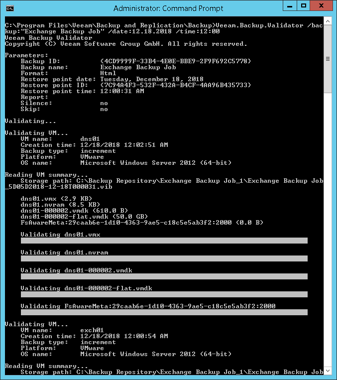

Example 3
This command validates all VMs in the Exchange Backup Job file created on December 18, 2018 around 12:00 AM.
Veeam.Backup.Validator /backup:"Exchange Backup Job"/date:12.18.2018 /time:12:00 |
