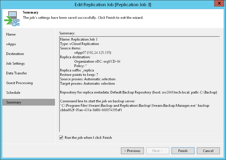

Step 14. Finish Working with Wizard
At the Summary step of the wizard, review details of the vCD replication job. If you want to start the job right after you close the wizard, leave the Run the job when I click Finish check box selected, otherwise clear the check box. Then click Finish to close the wizard.
